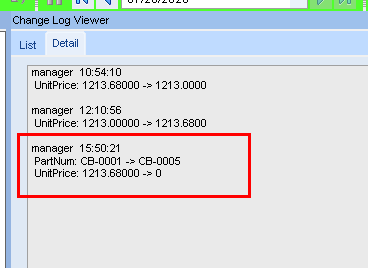

I have done some work on the Change Log. I have it to where it shows most of the data I’m after. The issue I’m having is with previous part number on the OrderRel table. When I upload the data change for part number it shows the change on the part number, but Previous Part Number is still blank. Does this populate from a different area from OrderDtl Partnum or OrderRel Partnum?

The ChangeLog (on the OrderDtl table) will capture it.
What do you need it for? If its for anything that’s automated, then the ChangeLog file has shortcomings, and is a pain to parse.
The most important thing to note about the changelog is that change log records are tied to table records. If that table record is deleted (like deleting a line or a release), the changes associated with that record are lost. For example:
New line (Line 2) added to an order.
Changelog contains manager 10:23:29 New Record
Line 2 P/N changed from CB-0001 to CB-0003
Changelog contains: manager 10:23:29 New Record manager 10:24:54 PartNum: CB-0001 -> CB-0003
Line 2 deleted
No change Log records exist
New line added, set P/N to CB-0003
Changelog contains manager 10:28:50 New Record
So from the change log it looks like CB-0003 was added as the “2nd line”, and no changes were made since the record was added.

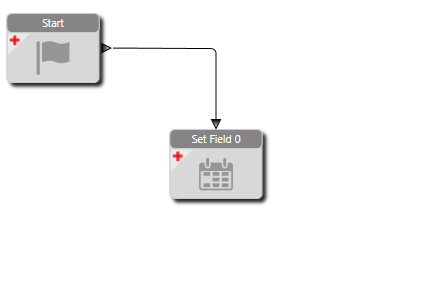

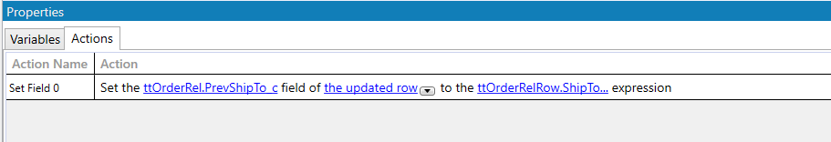

Whats a DD? Still trying to keep track of all the acronyms. Currently I’m trying to build a BPM workflow that sets the UD field ttOrderRel.PrevShipTo_c to ttOrderHedRow.ShiptoNum using preprocessing. However, the UD field is not receiving any information.

MD’s (or “BPM’s”) - work on “Business Objects” (BO’s). The easy way to think of these is that they can be triggered when specific application functions happen. The BO for SalesOrder, has many functions that are called when the client program does various things. The function that is called is known as the “Method”.
For example, the BO SalesOrder , has a Method named ChangeDiscountPercent. When the Discount Percent is changed on an order, it is the function that is called to recalculate discounts.
MD’s have two types, Pre- and Post- Processing. One will ahppen before the builtin method happens, and the other after.
Updating info outside of the scope of the BPM (the db table in a DD, and the tables related to the BO in a MD) can be difficult.
DD’s are best for very simple things, like updating a tables UD field, on a new record creation or change. For example, say you have a UD field Created_c in a table, and wanted to set that field to the DateTime when the record is created.
MD’s are much better for complex actions that might span several tables. Like how a Sales order has Header, Detail and Release tables, and you might want to control something in the Header, when info on a release changes or meets some condition.

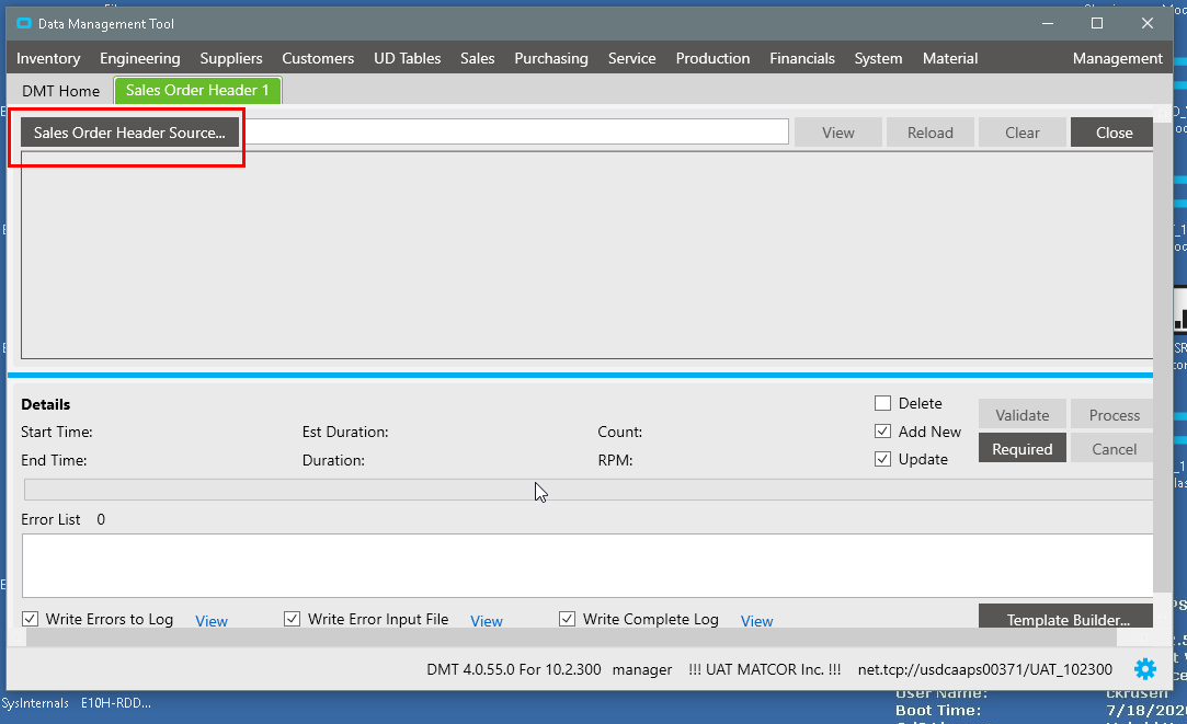

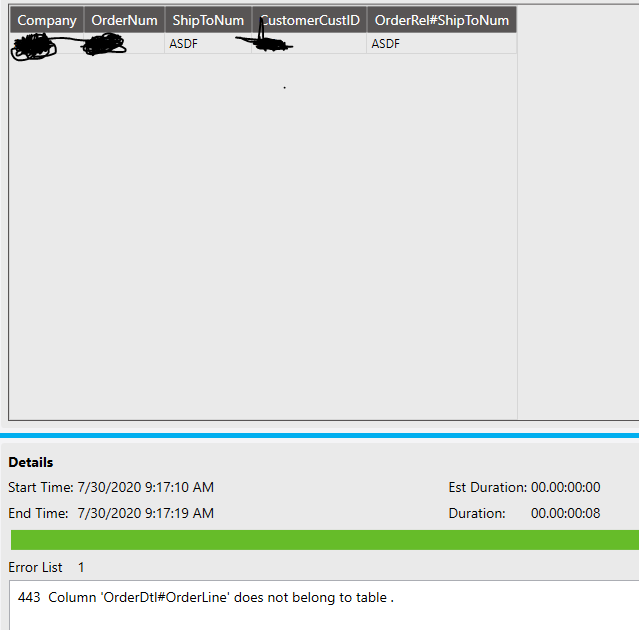

Ran into another problem with DMT. I need to be able to update ShipToNum. If I select ShipToNum and update it assigns the value to the OrderHed table and doesn’t trickle down to the OrderRel to populate the PrevShipToNum that I need for our report to compare against. If I go into Template builder and add in:
