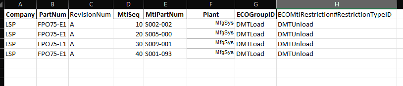

Hey Nate,
this is a dumb question but have you tried adding" ECOMtlRestriction#RestrictionTypeID" as a column in your upload file?
I had the same issue while trying to delete bill of materials and I was trying to get rid of duplicates like you suggested and it didn’t really change anything but when I added the “ECOMtlRestriction#RestrictionTypeID” column it ran and deleted the materials.
For your reference:
I didn’t try that. I think the template was asking for that field, but I didn’t have anything to put there. Where did you get the values you used for that field?
I made it up just like a transaction reference field.
