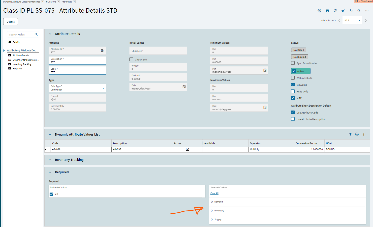

Attribute enabled for MRP are Required everywhere.
It likely refers to the Demand, Supply, Inventory options seen here:
However, the data doesn’t exist in the DynAttrClassDtl table and the DynClassAttrDtlReq table doesn’t exist in the DMT template.

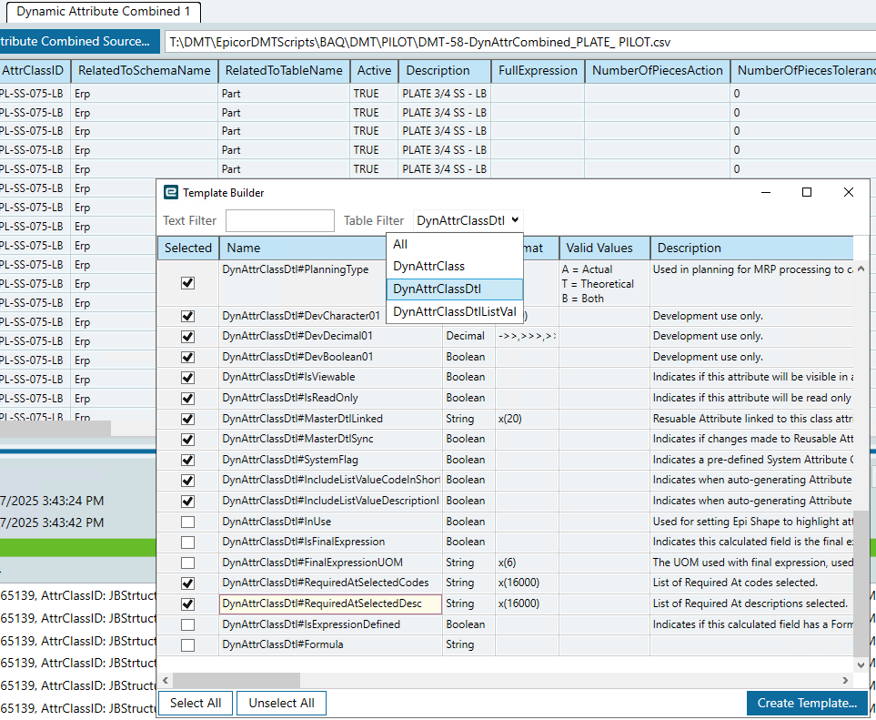

The closest I can find are the two fields seen here
(DynAttrClassDtl#RequiredAtSelectedCodes
& DynAttrClassDtl#RequiredAtSelectedDesc)
but these don’t exist in the DTL table either so how would I know what to populate in them?

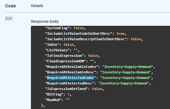

Looking at the REST API response, it seems the correct format for these field values are like so:
Inventory~Supply~Demand
Tried that in DMT and it works.
