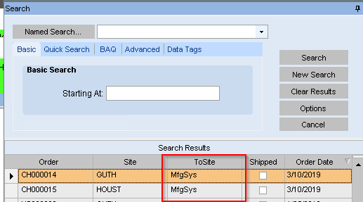

I was tried to create 2 TO’s (just the headers) with the “FromSite” as two different sites.
DMT says everything went fine
Import: Transfer Order
Started: 3/10/2019 2:54:44 PM
Finished: 3/10/2019 2:54:44 PM
Duration: 00.00:00:00
Records: 2/2
RPM: 335
Errors: 0
Import Mode: Add
Version: DMT 4.0.41.0 for 10.1.400.23
But looking at the TO’s created, shows that both were created as being from site MfgSys (which was the last site I was in, while in E10)
I then switched to another site, closed E10, and ran DMT with the same file.
It created two more TO’s Identical to the first.
Tried a 3rd time just swapping the To and From on each record for DMT, but got an error.: “To and From sites cannot be the same…” Seems that DMT still thinks I’m in “MfgSys”
