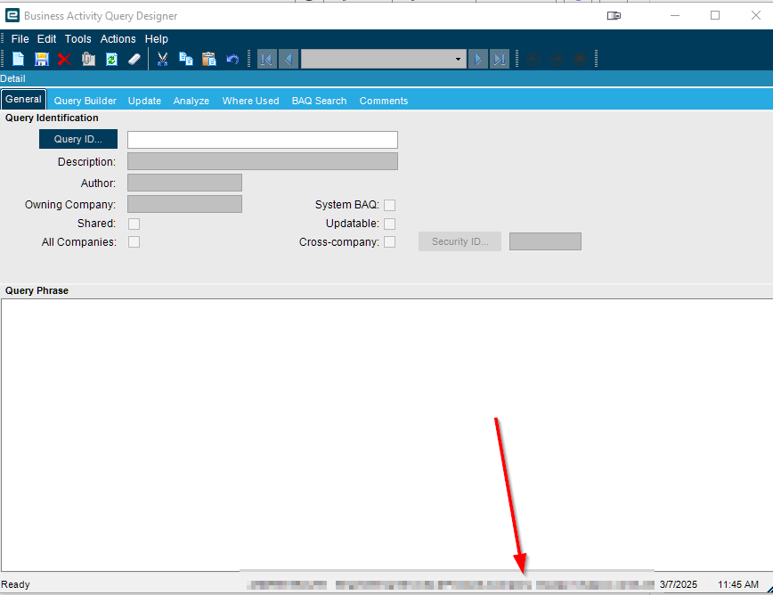

We just upgraded to 2024.2. It is possible to globally set the status bar for everyone, in every company? It’s great to see the environment, user, and time in the status bar on screen shots. But I’d rather not ask 150 employees to set it manually.
Can we DMT it? Any other way?

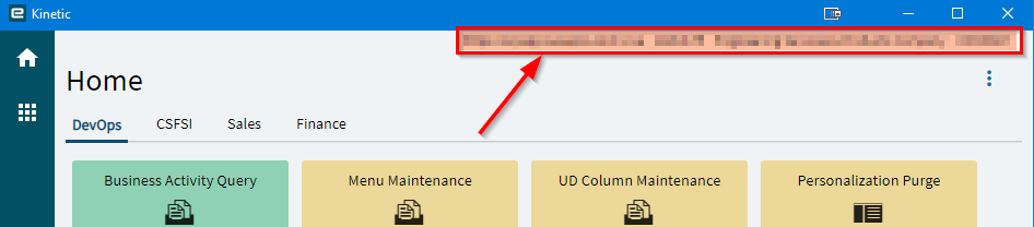

If they are using the browser - the information will always be in the upper right hand corner. :wink:

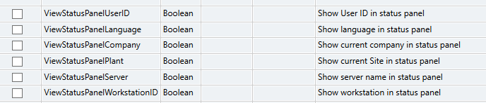

I would think that the DMT for Users would allow you to set the status bar panels in Classic.

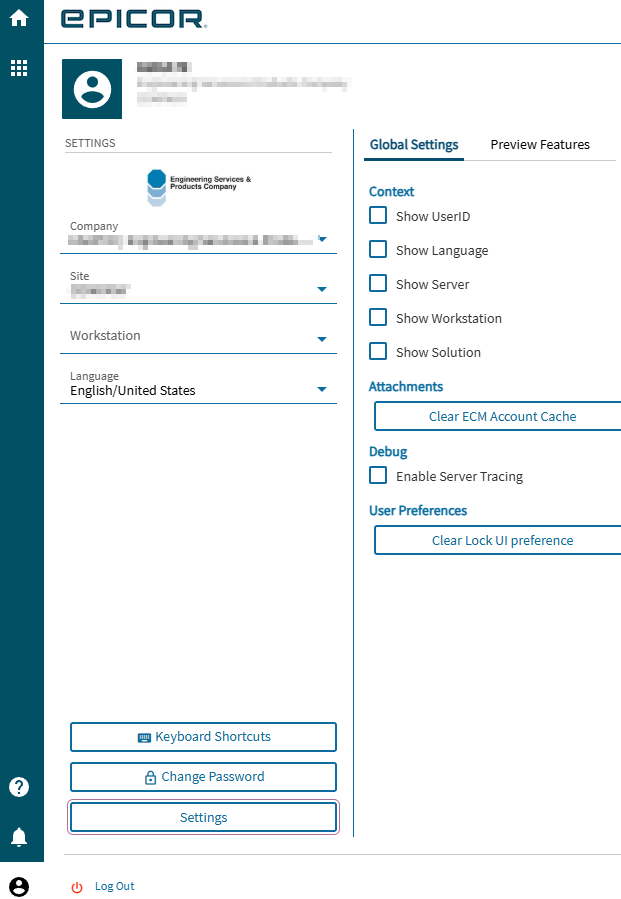

It looks like the UserFile settings only affect the Kinetic Browser status bar (top right), and not the classic client (bottom right)
When I change the settings here, I can see it change in my UserFile BAQ, as well as my browser Kinetic (in the top right of the window).

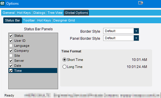

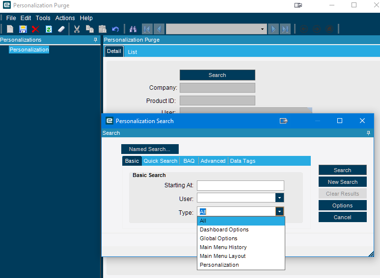

The status bar doesn’t change for classic screens. That seems to be tied to a Global Options personalization. Is it possible to generate them for all 150 users in bulk?
What I’ve had to do is use Ice.SysUserFile in a BAQ to display the information I need to run the User DMT. I don’t think there’s a way to use an updateable BAQ to make it work because of that ‘behind the scenes’ linkage between Erp.UserFile and Ice.SysUserFile. But I’ve run the DMT for User to set things and it works.
