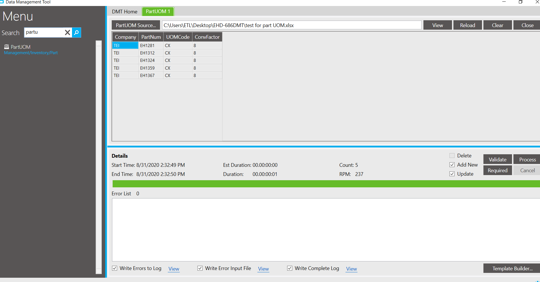

I created a new UOM on the UOM table and added it to the appropriate UOM Class table (UOM is called “CX”).
When I view the Part UOM table for existing parts, the new UOM (CX) is available and allows me to set the ConvFactor.
When I attempt to DMT in PartUOM, the DMT tool appears to show the records as if they updated for “CX”, however, when I return to the Part UOM screen the ConvFactor is still showing “0”.
During testing I have found the new UOM (CX) does not appear in a BAQ search, until I physically go to the individual Part UOM screen, change ConvFactor on the new UOM “CX” and save. The action of clicking into ConvFactor on the new UOM seems to activate the UOM (CX) for the 1 specific Part Number I was on. BAQ search then picks up “CX” on that 1 specific part number and DMT works fine on that 1 part number.

Yes, I feel like I should be able to update this with DMT because it is simple as a user. 2 passes was my 1st thought too, I tried a few different iterations of the DMT file (with and without ConvFactor on the 1st pass). Also tried messing around having the “ConvOperator” & “ConvOverrride = TRUE” columns in the DMT files, but nothing seems to be effective through the DMT tool.
Yes, I added it to the UOM Class before trying the DMT

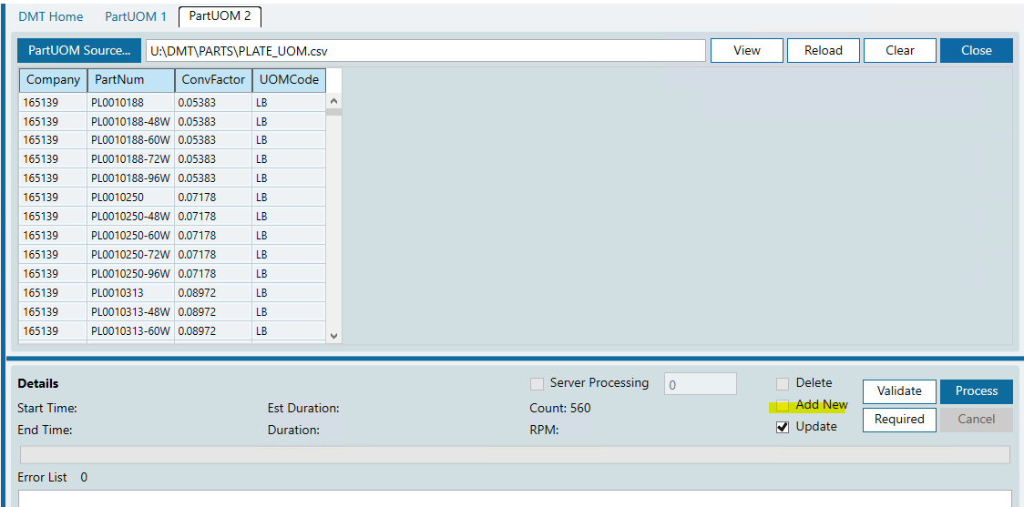

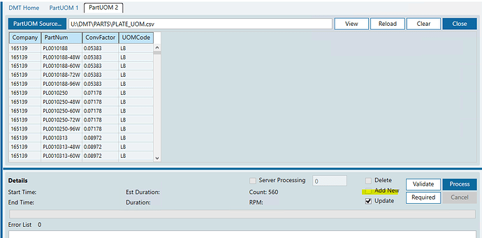

Sorry old post. Ran into this today. PartUOM DMT runs fine but ConvFactor remains zero. I know it worked the last time. I believe it indeed takes two runs or possibly more than that. Oddly, AddNew is disabled on mine. Anyway it worked after two or three runs. Thanks!
When you set the UOM Class the UOMs are created, so it is just updating the factor and possibly the operator. I also have the operator in my last run and it went in in one shot.
Class was definitely pre-set on part masters and has operator but I’ll add operator to PartUOM next time and try for a one-shot. Thanks again.
