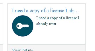

In EpicCare on the home page there is wayfinder. You need to go there and find the wizard for I need a copy of a license I already own and they will issue you a new file with DMT in it. After you load that license and enable the DMT module, restart the app server and if all is aligned in life you will get the DMT option.
