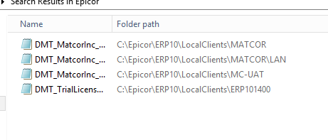

I don’t recall installing DMT several times (and in different locations), but I did find the executable and license files in several locations.
Maybe your user is launching one of the “other” installs

Make sure they are not running dmt from an old location like the server directory. Check the shortcut path they are using to launch the dmt.

  2. Remove the file probably named DMT_PriorScientificInstrumentsLimited 19.07.2013 and replace it with the attached, keeping it in the same location.*
  • Be aware the .lic file could be present in multiple locations. If so, replace both files.
