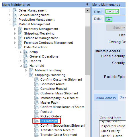

I know this is an old issue, but does anyone know what the correct set of permissions are to do the PO Receipt via DMT? I have tried some of the obvious stuff by I am still stumped as to what is not set correctly.
I found this in an EpiCare article. You need to go under the Data Collection-> Handheld menu to get the right PO Receipt menu item to tie to the DMT.
