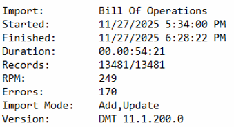

This doesn’t just update the operation, it actually does a lot of things! If you’re pushing an update to a checked-in and approved revision, for each updated operation DMT will unapprove and check out the parent part’s revision, make the update to the operation (here’s where your change is written to PartOpr), then check in and approve the parent part’s revision. From your perspective it’s a one-step update that automatically does all of the steps we’d do in the real world. The downside is that it’s slow by DMT standards, I usually see 6 to 10 updates per minute.
The only thing to watch out for is that last check-in operation. Sometimes it isn’t successful. Like, less than 1% in my experience. Just check engineering workbench for any stragglers under the ECO group you used for your DMT set.
This is something that will bite you especially on larger runs. I usually run over 200 rpm. I am mid implementation and got this on a recent run. Maybe it is a SaaS thing.
