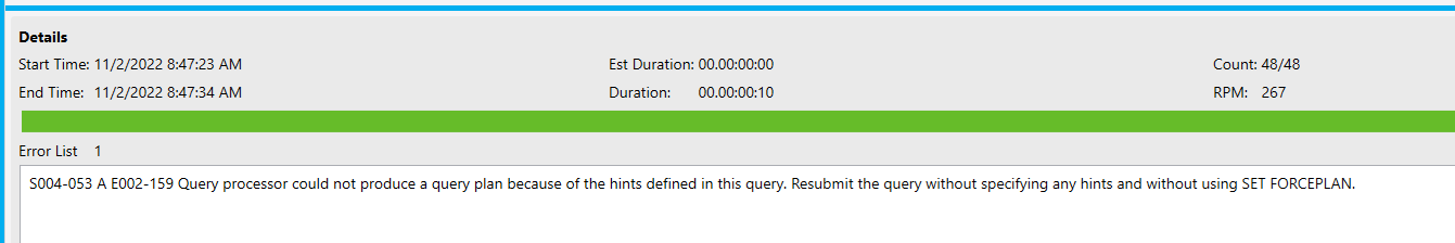

When the DMT is uploading the Bill of Materials, it is giving the following error:
In this case, S004-053 is the assembly and E002-159 is the last item in the BOM.

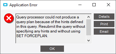

If I go to the Engineering Workbench, I see S004-053 checked out in the group with all the material added to it. I can remove material and add more without any errors, however when I try to check in the part, I get the same error as the DMT does.
Application Error
Error Detail
Message: Query processor could not produce a query plan because of the hints defined in this query. Resubmit the query without specifying any hints and without using SET FORCEPLAN.
