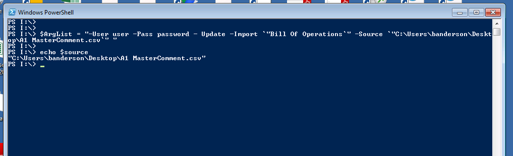

This should work:
$ArgList = "-User user -Pass password - Update -Import `"Bill Of Operations`" -Source `"C:\Users\banderson\Desktop\A1 MasterComment.csv`" "
Tried that. It doesn’t like the quotes on file location. It’s not the string in the variable itself. The argument for -Source doesn’t want to take anything with quotes in it.
yet it is okay with the "Bill of Operations" after -Iimport ??
yeah, frustrates me too.

The above builds $ArgList such that you don’t need quotes on your “process-start” line
Still file not found. The location Bombs out at the space.

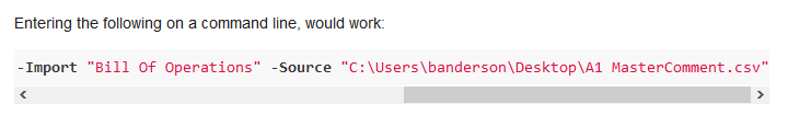

Just so we’re on the same page,
Entering the following on a command line, would work:
C:\Epicor\ERP10.2Client\Client\DMT.exe -User user -Pass password -Update -Import "Bill Of Operations" -Source "C:\Users\banderson\Desktop\A1 MasterComment.csv"
Does entering in the PS
Start-Procss -Wait -FilePath $DMTPath -ArgumentList 'C:\Epicor\ERP10.2Client\Client\DMT.exe -User user -Pass password -Update -Import "Bill Of Operations" -Source "C:\Users\banderson\Desktop\A1 MasterComment.csv" '
work?
no this does not
wait, command line. I thought you meant in Power shell. I haven’t tried it in command line.
That was just executing the DMT.exe. If that failed then it’s not a PowerShell thing.

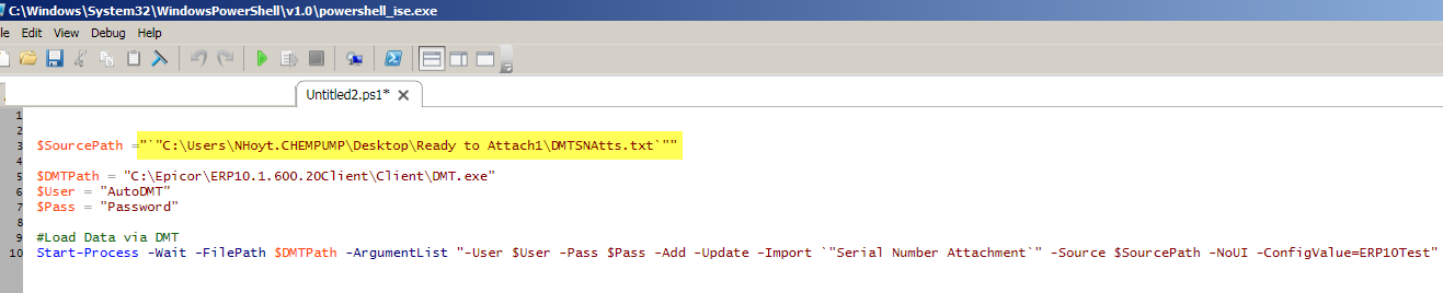

Hi Brandon,
I am working in the same area right now, powershell to run DMT. I just tested with spaces in my folder name and found it did not work unless I added extra quotes. This worked in my testing:
$SourcePath =""C:\Users\NHoyt.CHEMPUMP\Desktop\Ready to Attach1\DMTSNAtts.txt""
Nancy
