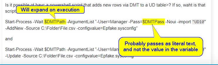

Is it possible ot havc a powershell script that adds new rows via DMT to a UD table>? If so, waht is that script? I ahve tried
Start-Process -Wait $DMTPath -ArgumentList “-User=Manager -Pass=$DMTPass -Noui -import "UD10
" -AddNew -Source C:\Folder\File.csv -configvalue=Epfake.sysconfig”
and
" -Update -Source C:\Folder\File.csv -configvalue=Epfake.sysconfig”
The first one, doesn’t do anything, the second one errors out saying that it couldn’t find the data in the table.

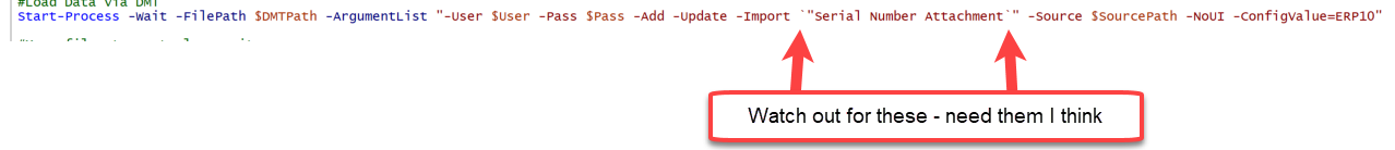

Hi Will,
IDK if there’s anything special about the UD add new. I’d run it manually via DMT to ensure data going in good, then take it for automation via Powershell.
I have serial number attachment records getting uploaded. I got it going via following this thread from Rick Bird (thanks Rick!), and the code below:
#Load Data via DMT
Start-Process -Wait -FilePath $DMTPath -ArgumentList “-User $User -Pass $Pass -Add -Update -Import "Serial Number Attachment
” -Source $SourcePath -NoUI -ConfigValue=ERP10"
Nancy

On the lines of what @Nancy_Hoyt was saying, the use of variables(that contain strings) in a power shell script can get dicey.
I think the $DMTPass
in the -Arguments
parameter won’t be expanded.
You might want to try making a string variable to hold the all the arguments, and pass that to the Start-Process command.
Edit
Or make it a list of arguments, by separating them with commas(like):
Start-Process -Wait $DMTPath -ArgumentList "-User=Manager", "-Pass="+$DMTPass, "-Noui", "-import", "`"UD10`"", "-AddNew", "-Source C:\Folder\File.csv", "-configvalue=Epfake.sysconfig"
2nd Edit
The MS page says
For the best results, use a single ArgumentList value containing all of the arguments and any needed quote characters.
So maybe the above isn’t the best. but trying to make a string that contains other strings that contain quotation marks can get tricky.
