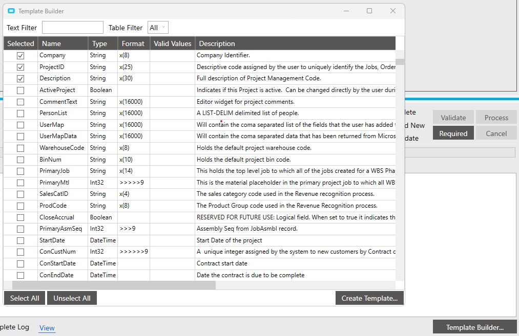

You can go into the DMT tool and look at all the tables and fields by selecting the ‘Template Builder’ option. If you want it will even create a template for you for the selected fields when you select ‘Create Template’.
**I legitimacy feel like I’m making suggestions on a different software when I post on here. I am still on 10.2.500 (hoping to upgrade soon).
When it comes to DMT, it’s still basically the exact same. I know how to create templates. But what are the proper order of DMT templates that I need to create and load. That’s where I’m struggling.
