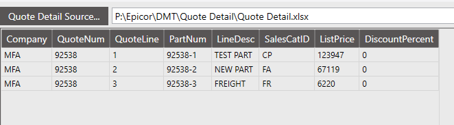

I am trying to enter Quote Details with DMT. I was able to enter the Quote Headers succesfully but I am having trouble with the details. I can’t seem to get the price in there. There are what seems to be a bunch of price fields but none seem to work. Does anyone have any experience with DMT and Quote Details? Here is what I am using:
And here is what ends up in Epicor:
Nothing fancy here just a part (not in part master), a quantity, a price, description.

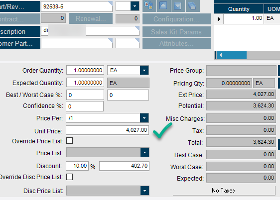

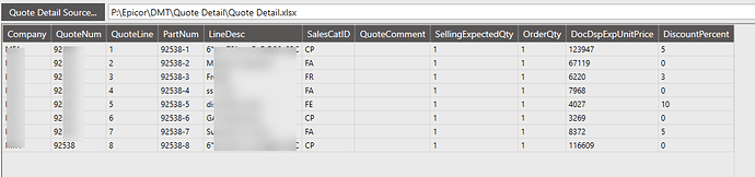

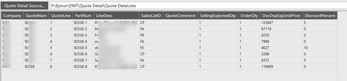

OK figured it out. I’m not actually sure what I did but these are the fields I boiled it down to and it works now! :stuck_out_tongue_winking_eye:
OK well it turns out that that was not the solution. I thought it worked because I saw numbers on the quote but those numbers are not from the DMT import but the price from the Part master, which I don’t want.

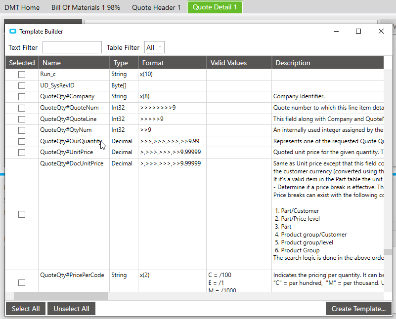

I’m about to do this myself - I think it might be the QuoteQty where the price needs to be.
I’ll update once I’ve had a go.
Mark
Hi,

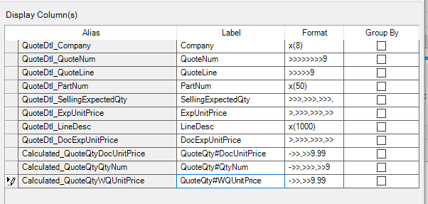

Confirming this it’s QuoteQty#WQUnitPrice that does this.
Mark
It was DocDspExpUnitPrice
