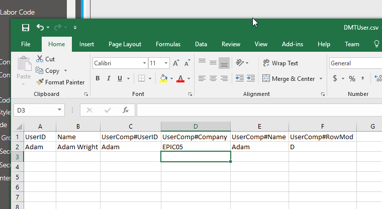

This template will do it (Run it as Update)
Template: DMTUser.csv (113 Bytes)
As @Mark_Wonsil mentioned, it’s a status flag on a row as to how to process the row.

Jose, UserComp#RowMod was the piece I was missing. Running a file that adds a new company and deletes the old company using the rowmod is perfect, it gives me the exact results I need.
UserComp#Company,UserComp#CurPlant,UserComp#PlantList,UserID,Name,UserComp#RowMod
FCN,MfgSys,MfgSys,dwilhelm,Denis Wilhelm - dwilhelm,A
FIM,MfgSys,MfgSys,dwilhelm,Denis Wilhelm - dwilhelm,D
