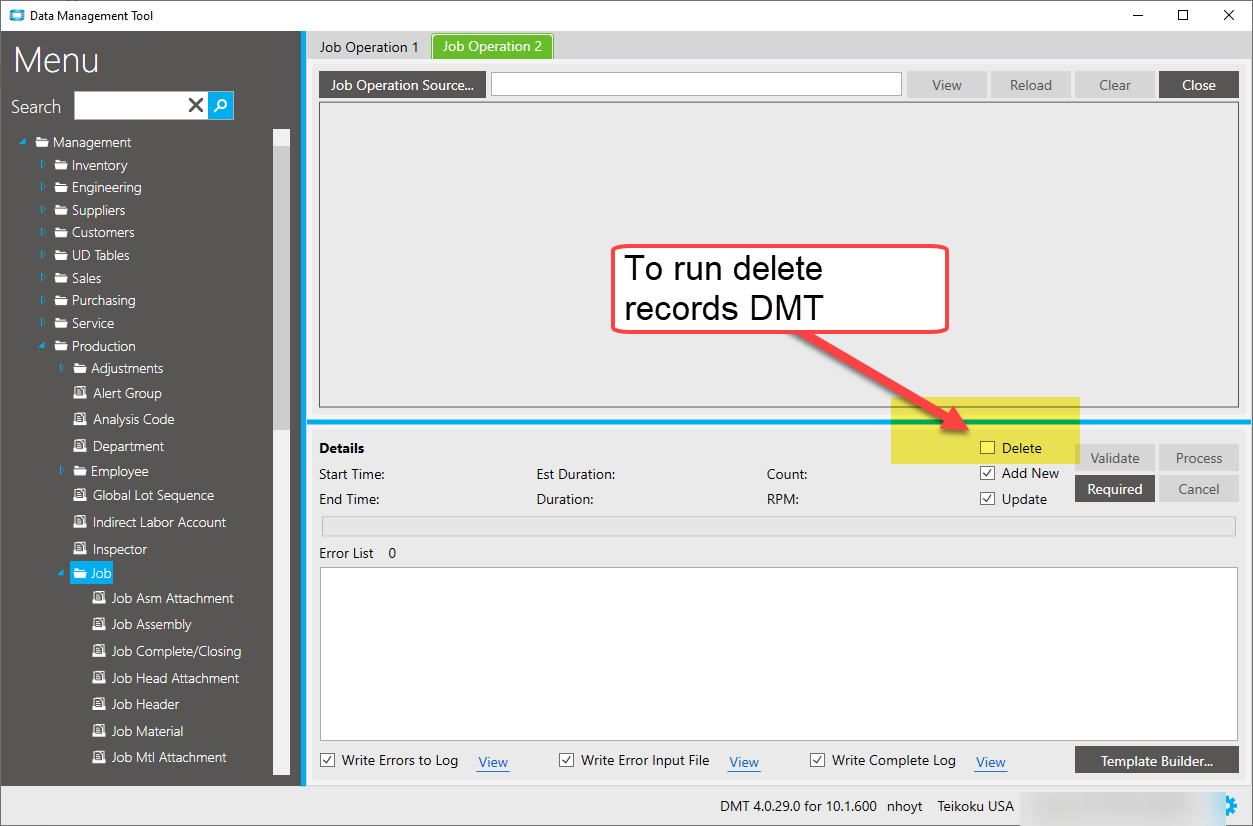

Perhaps DMT has changed significantly from my version… I have never input a rowmod in loading up or deleting methods. Our version has a checkbox for deleting. Any chance you have one of these too (screenshot)?

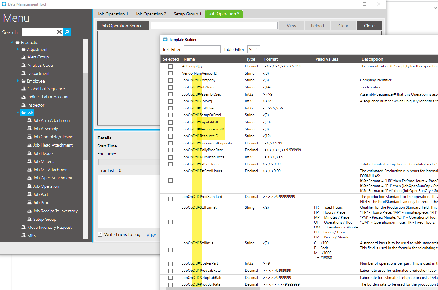

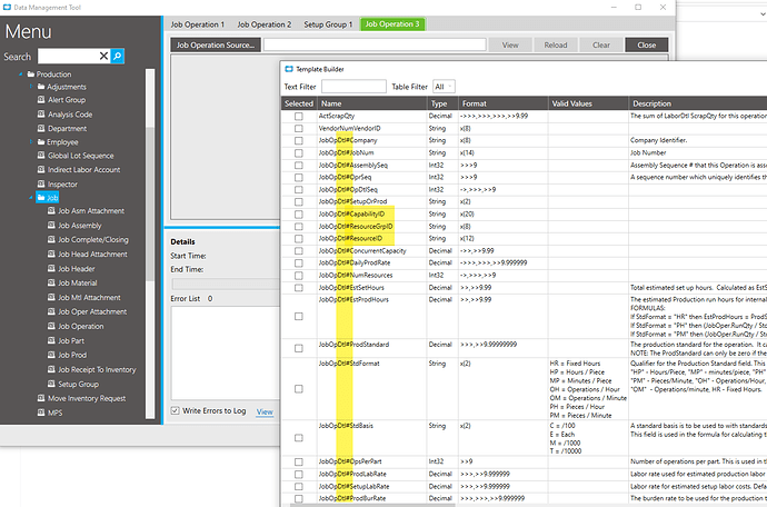

I think that the JobOperation template builder should be used, with particular attention to the JobOpDtl# fields. These are in the JobOpDtl table and DMT is combining them. I recommend tossing your subject job(s) in a UD and doing a query to get the operations for the subject jobs and trying to get a handle on at least the indexes in there for JobOpDtl too and do the delete using that. On an aside, I was told by scheduling experts to only have a capabilityID or a resouregroupID or a resourceID, never more than one ID or you won’t be able to let the scheduling engine do its work. We haven’t worked with finite scheduling in awhile however.
You might want to run global scheduling after doing the DMT to get your jobs to all reschedule… I’m not sure how the jobs will get rescheduled with just the DMT.
Nancy
Yes, The DMT does have the delete field. I think the Epicor tech suggested to add that rowmod flag for the OpDtl record. As the Job Operation program in DMT only works on the job operations and not their operation details. I am holding off for now. I think that we are going to have to do some serious thinking about how our open jobs will be updated.

To add I would recommend whenever you have a field with # in the header include both the # version and none # version.
e.g. use OprSeq & JobOpDtl#OprSeq both with the same data. Just looking at my DMT version it says jobopdtl#opdtlseq is system assigned so I would try leaving it out

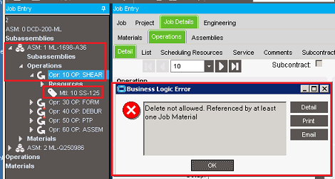

Just curious if you have you tried manually deleting a sub-assm op in Job entry?
I am able to delete sub-asm ops… as long as they don’t have related materials.
If this is the case, then possibly another template first to reassign or delete related materials before changing sub-asm ops?
Haha I tried that while you were typing it. Great minds, huh? The op that has assemblies will not allow me to delete, it, but all the others ops delete just fine. But DMT still throws that error for all the ops. Very strange!
