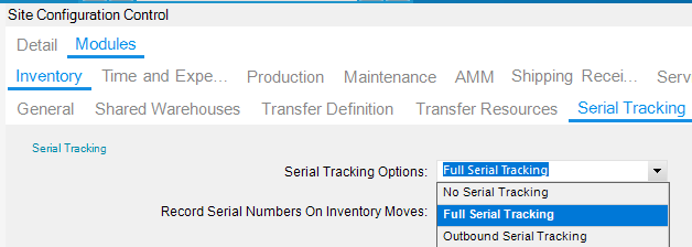

Have you considered changing serial tracking to outbound only?
Then you only need to record the serial number when you use it.
