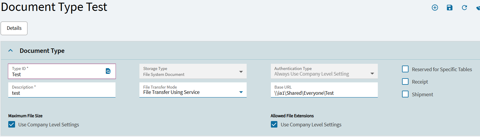

I can now attach a new file to my test customer via the browser, and open it via the browser as long as the Document Storage Type is ‘File System Document’ and the File Transfer Mode is ‘File Transfer Using Service’. Woohoo!

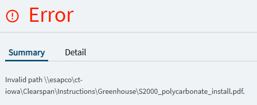

I took one attachment link file on one test customer, and with the Ext File Ref DMT template, changed the DocTypeID to ‘Test’, my File System Document type. Unfortunately, it does not open. I can paste the file path into the browser URL bar, and it will open the attachment. What am I messing up?
I suspect base file path has something to do with it.

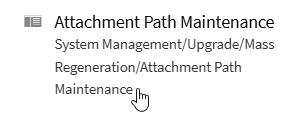

Did you try this?
Whoa! I never knew about that. Thanks - will check it out!
Update:
This seems to update the base URL for attachments that use that doc type. Unfortunately, our linked file attachments are all over the various folders, and doesn’t follow a consistent base url. It does look like a nice front end instead of doing DMT, if the situation worked.

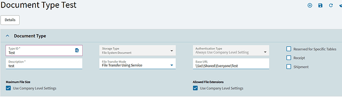

In Document Type Maintenance, I changed an existing doc type from Storage Type ‘Attachment Link’ to ‘File System Document’, and then set the File Transfer Mode to ‘File Transfer Using Service’ (e.g. FileTransferMode = 1). This results in the error when trying to open existing attachments.

From help:
If you set up a new file server to store your file attachments, you need to change the base directory path to this file server. You can do it through File Attachment Maintenance. You update the base path for a group of file attachments that use the same document type, preserving the links your records have to these files.
Note that this app only updates the internal directory path to these files. It does not move these files, so you need to manually place these file attachments in the new base directory on the file server.
