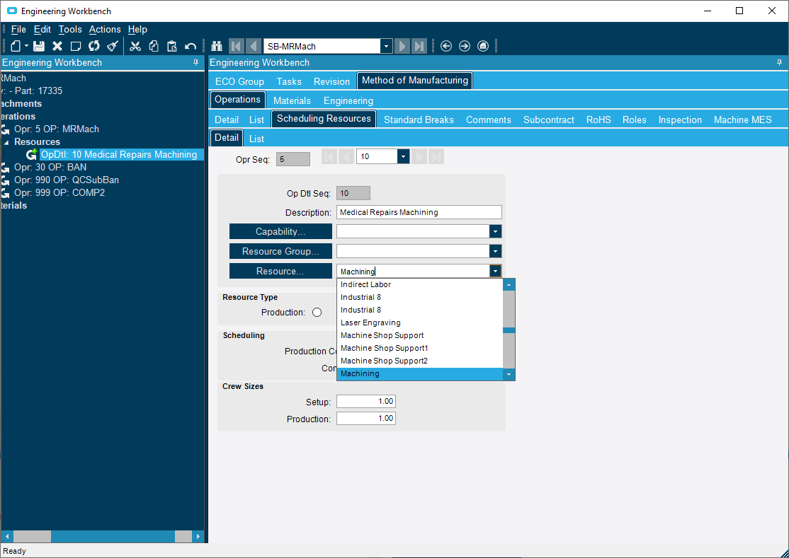

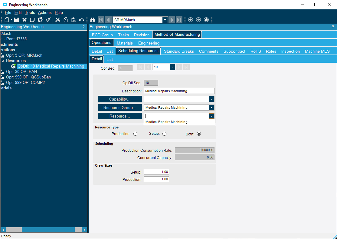

I think the biggest issue here is they want only a Resource to be selected on the operation. Currently a group is selected, and the resource they want is not part of that selected group.
Images to illustrate.
How it’s currently setup
How it needs to be
Notice that Machining is only available after I clear out the previously selected resource group.

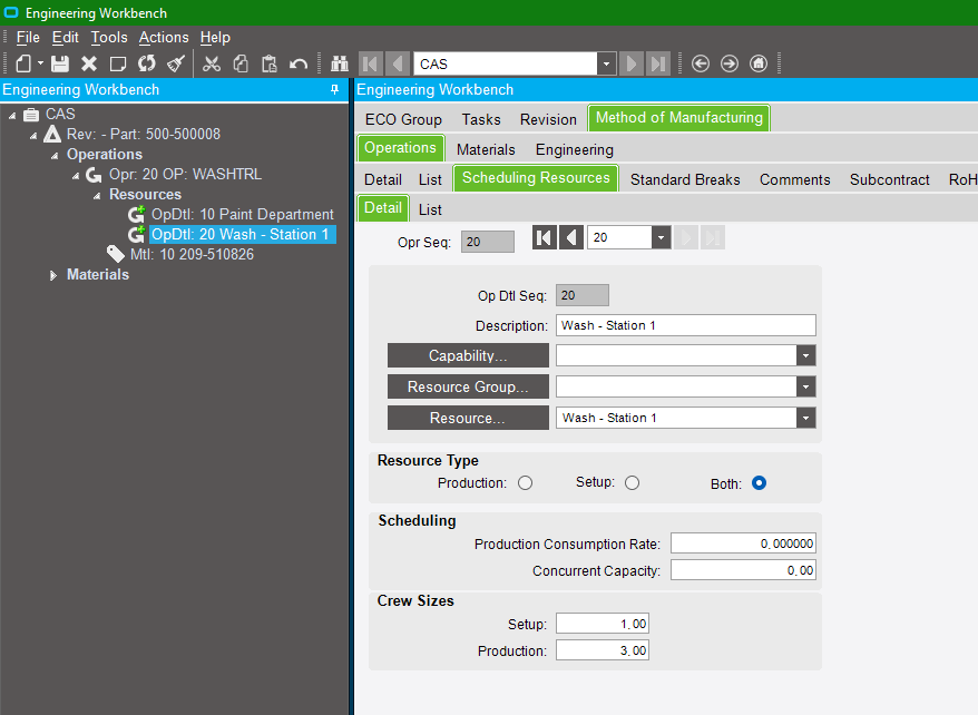

Yes, you should be able to use the DMT tool to update this as you are wanting using the template fields I specified, but they really need to be in that order or it would glitch on me not positive why.
ECOGroupID Company Plant PartNum RevisionNum OprSeq EstUnitCost OpCode OpDesc ProdStandard StdFormat StdBasis EstScrapType LaborEntryMethod AutoReceive FinalOpr QtyPer ECOOpDtl#OpDtlSeq ECOOpDtl#ResourceGrpID ECOOpDtl#ResourceID ECOOpDtl#OpDtlDesc
ECO Company MfgSys 500-500008 - 20 0 WASHTRL Wash Trailer 3 MP E % Q FALSE TRUE 1 20 WASH01 Wash - Station 1
Like this?
