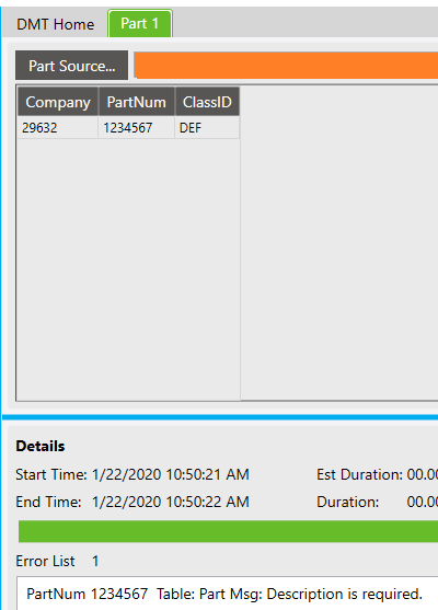

Lately âDescriptionâ is required for deleting or modifying some records with DMT. This is really troublesome for me. We often have to mass-update a UD field on Project, for example. I think itâs pretty absurd to have to export the description of every project and re-import it just to update an unrelated field.
I put in a ticket today and was told âthis is by design.â Honestly, he was sympathetic but said itâs all or nothing on required fieldsâif required on add, itâs required on update/delete. Or it would require extensive additional coding, I think is implied.
I feel like that was not always true, but we are on 10.2.500 now so I guess I canât revert to an old version.
Point is, should I push the description-required issue with support?
Edit: Who am I kidding? I am always going to push an issue with support.

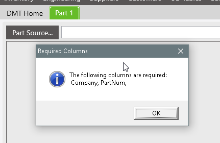

We have seen in older versions (E9 and E10) of DMT that Desc was noted ârequiredâ on some templates⊠but when you uploaded it didnât really have to be in there. Are you basing the need for Description on an actual Fail of the DMT without it, or on the template required fields?
Does it mater if the description in your DMT file matches the existing description field? If not, just make the column in the DMT file and fill it with âDELETEDâ
@richardh I hadnât tried yet. Certainly crossed my mind with the uBAQ (have not done a REST update personally before). I really just want the DMT to work smoothly.
@Nancy_Hoyt Good point, but yes it actually fails on import (see pic at end of this post).
@ckrusen Right, for deleting, a bogus description works fine (just tested it with JobMtl). My problem is updating. I want to update a UD field in Project without being required to populate the project description with what it already is.
Yeah that is the bigger issue. Lots of tables have some required field like a Description, that you want to leave alone.
The logic in DMT should be that required fields are only required for new records. Let the BO handle updates, that canât complete because of incomplete info.
