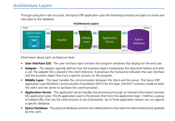

The really simple thing would be to use SQL to just update the database, but I understand that’s not a viable route due to the fact that it bypasses all the business logic.
It sounds an interesting project, I just suspect that by opting for conceptual simplicity you may be opening the door to headaches in practice. The actual workings of the DMT are, I believe, based on the UpdateExt methods of the associated Business Objects, and if you have a working set of fields for the DMT you can usually use the same directly into that method and have it work with fewer moving parts. Still, if CSV and DMT are known quantities, don’t let me derail you.
Your not only bypassing the business logic, by doing so (and if Epicor finds out) I’ve header your losing service support by Epicor… or something like it. Can somebody be more specific here please. I’m not to aware of the terms of agreement.
yes you can not use direct SQL code to add, update, or change any values within Epicor DataBase, you only allow to do that through BPM and Customisation using the relevant/available BO methods within Epicor forms UI
