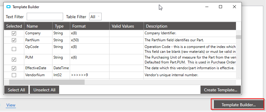

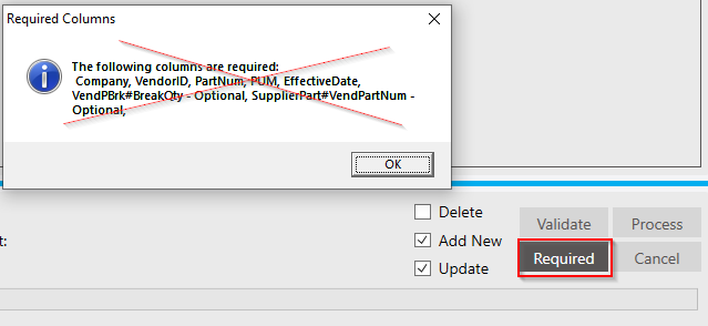

Within the CSV file, are there specific fields that should be used when doing the DMT? For example, the calculated field should I rename to be Ship By and not include the original Ship By? Also would I just use the Sales Order Header DMT table?
{Company, OrderNum, RequestDate, CustomerCustID} should be the only required columns?
