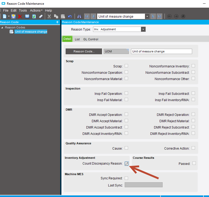

Yes. you can control what account it hits with GL control codes on your reason codes.
On your reason code you can specify which codes is a Count Discrepancy Reason. and on that code you can set a GL control and map the GL account you want.

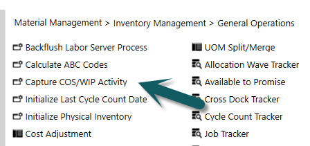

The Report shows you where the transaction will hit on the GL when you run the Capture COS /WIP activity.

The GL isn’t actually hit until you run the Capture COS/WIP process.

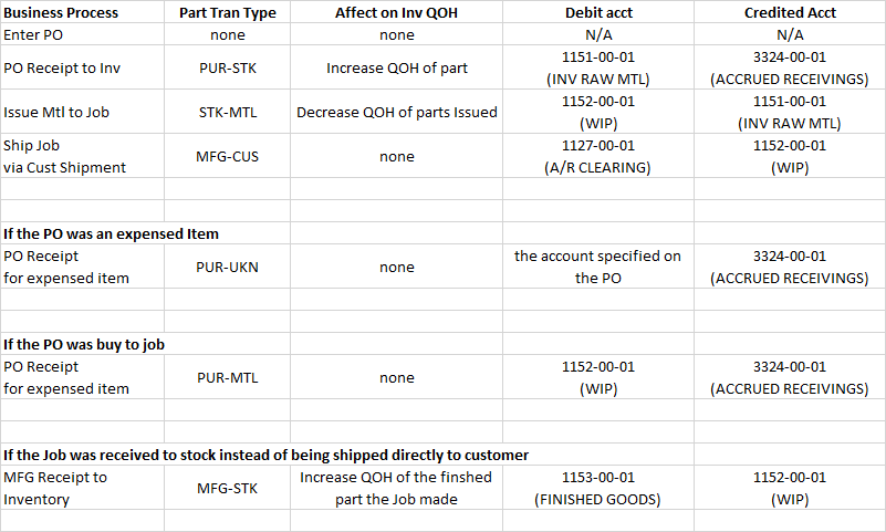

If you follow the guide, and review the transactions you conduct (you can see them in the wip capture), this will guide will let you know what accounts you need create for the each transaction.

Posting the Capture COS/WIP process, posts those summaries to the GL

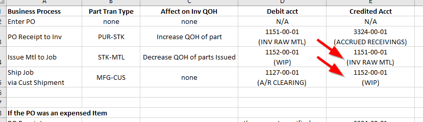

I strongly suggest finding a large whiteboard and making a chart like:
