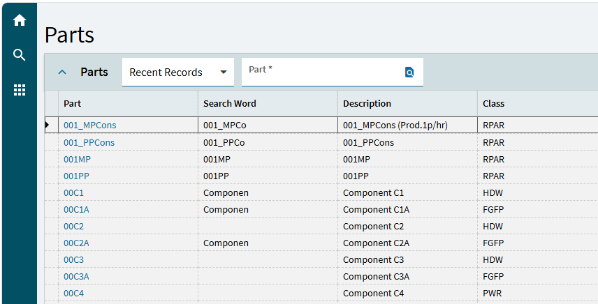

At some point, some of the landing pages offer “Recent Records”, which should be user-based. Part is one of those landing pages:

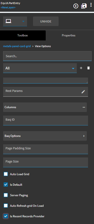

Not always what the user might want, but it’s a start. I’m not sure if it’s wired up or not. In the Panel Card Grid | View Options, there’s a place to check if the view is marked as “Is Recent Records Provider”, which I assume means it will record parts retrieved and stored by the user ID.
Recent records is useless. Its only records they have actually clicked on in that session. Once you navigate away its gone.
