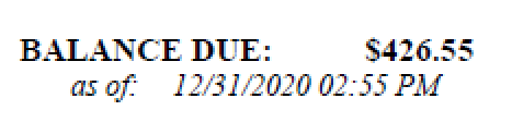

We settled on showing a balance with a timestamp, like this:
Please be careful, I had a customer that would create multiple invoices for the same sales order on the same day. Since the invoices can be printed before posting, the balance due may or may not be accurate.
