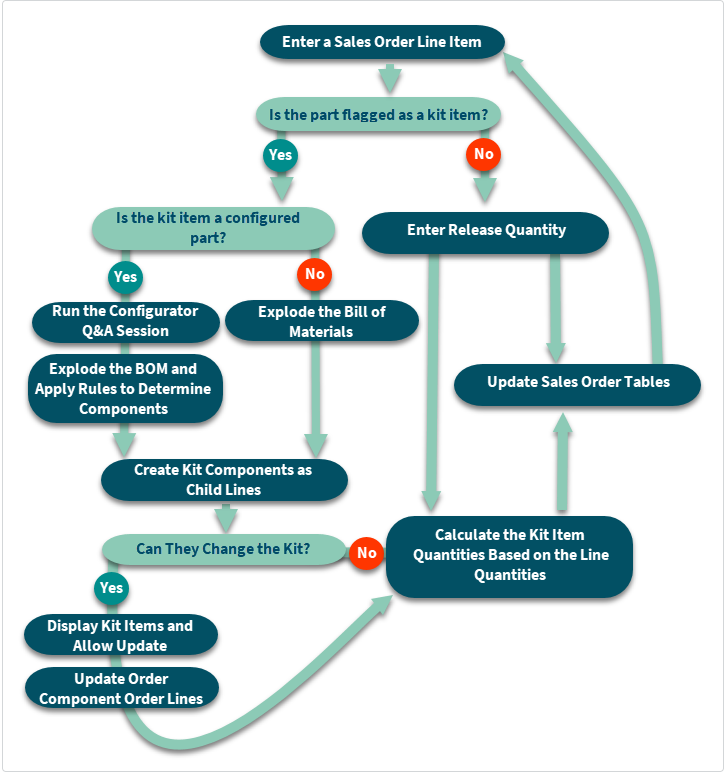

Do you need the configurator in Kinetic 11.2.300.6 in order to create sales kit parts?
We do not have the configurator and are trying to determine if we can use the Sales Kit part type.
I believe the answer to your question is “No”… Configurator should not be required to create Sales Kit parts. You should be able to assign a Part as a Sales Kit Type in Part Maintenance.
Having Configurator does allow you do perform additional things… but it shouldn’t be required.
Below is a flow chart found in Epicor “Help”… (search for Understanding Sales Kitting). The 2nd prompt is whether the kit is a “configured part”… but notice there is a path forward if the answer is “No”. You can still complete the sales process.
I’d say no as well, at a previous company we did not have Configurator yet had many kit part BOMs.
