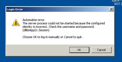

Hello, has anyone come across this login issue with doc-link.
I have recently changed my administrator password and not doc-link services will not start.

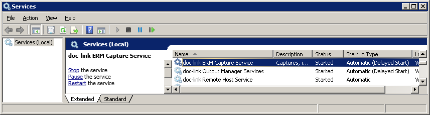

For those doc-link services that you might be using that Administrator account, did you update the Password on each?
Also, if you need to change the doc-link Administrator Password and you don’t want it to auto-login…Right-Click on the Administrator icon and choose either “Open” or “Run As Administrator” and it will prompt you for the doc-link Admin User Name and Password without trying to auto-login.
From Component Services, expand to COM+, then doclink.COM.
Go to the Identity Tab.
Enter the password for the Service User Account (“Login as This User”).
The 4 Doclink services – all need the password reset and started (because all passwords had been changed).
Start all services – Login to the Admin Console - OK now.
This worked for me
