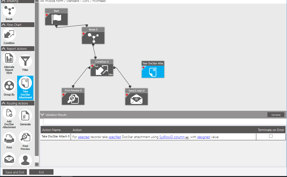

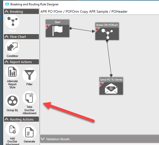

Do you also have APR? You mention break routing, so I assume you do. Perhaps this is what you are looking for. The ‘take document’ widget in the APR setup.
Correct. Where I am at is I do not exactly know how to properly configure the action whether it be a static document or another document.
where is your static document stored in Docstar - It needs to be an attachment to a table in Epicor. We would store a document like “Terms and Conditions of Sale.pdf” as a Company level document inside Epicor, attached to the Company record. And we get the SysRowID.
Then the params for the widget are
selected=‘ArInvoice’
specified=‘Company’
designed value = sysrowid
I think that will do what you want…

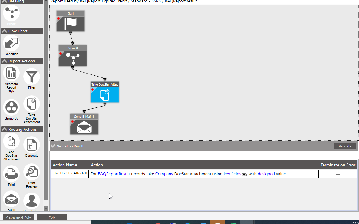

Ok it is working on my test just as needed.
  1. Create a Document Type “Company” and make it a docstar attachement
  2. Attach the file to the company
  3. In Break Routing use the take document type.
  4. Choose action options. I used key field to test and it does not require a key for single company.
If we need more documents I will have to visit the other action options later.
Works perfect, now I can start to build out the additional logic.
