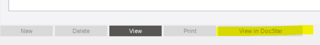

Notice on the Attachments page, there are two different buttons: View in DocStar and View. Are you tracing the View? That’s what you want to copy. Keep in mind that you’ll most likely have to authenticate to DocStar before retrieving any documents.
