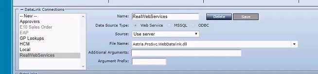

For anyone interested - I finally got some information and the extension from Epicor / Docstar.
They call it - Astria.ProSvc.WebDatalink datalink extension. It enables you via the Datalink Connection to call Epicor Rest API’s.
Video demonstration of its use: https://youtu.be/rN20hKoYLiQ

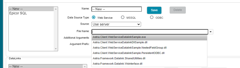

Has anyone been able to Create a Connector to then create a Datalink into E10 API’s? My end goal is to be able to write back some dates to an Engineering Schedule we house in a UD table as Docstar goes through the Workflows we are going to create.
I watched the video mentioned in another post about Rest APIs and Docstar.

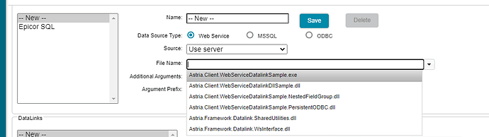

image image
This File name is not on our server Astria.ProSvc.WebDatalink.dll. All we have is this when I tried to create the connector while signed in as the Super Admin User:
Did you ever find that file? Astria.ProSvc.WebDatalink datalink extension

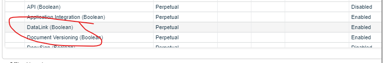

We were told we needed to purchase a different licensee go from DocStar to Epicor. Without that you couldn’t make the connection according to the TSG guys. I can’t remember the name of the add-on we needed… I’ll see if I can find it.
Is it this one?
