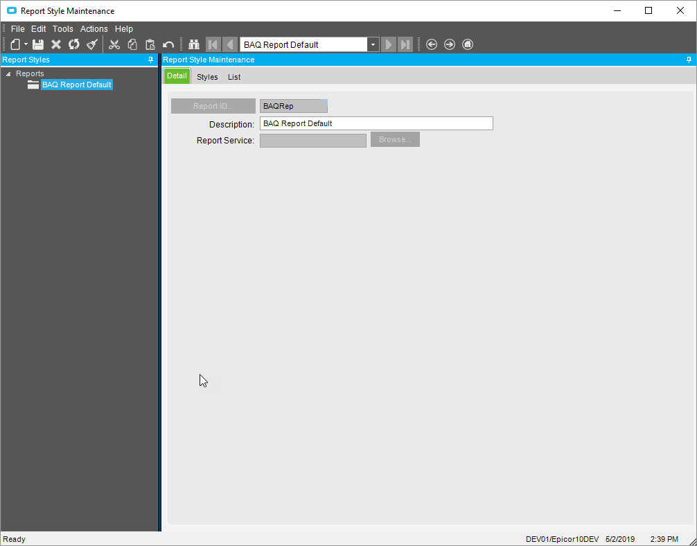

The Report setup un Doc Sender looks very similar to the Report Style Maint - whic does allow selecting BAQ Reports.
Looking now…I see a ReportID called BAQRep but no styles defined.
Are you saying it’s possible to define a style here and then interact with it via Document Sender?

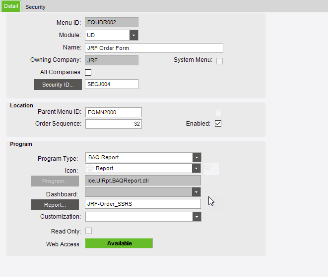

For our BAQ Reports, they are always deployed as menu items
The BAQ Report program just creates the underlying dataset (the BAQ) and the RDL. All BAQ Reports should also appear in Report Style Maintenance.
I bet Report “JFR-Order_SSRS” is available in Report Style Maint. Which I’m guessing, makes it selectable in the Doc Sender Report selection.

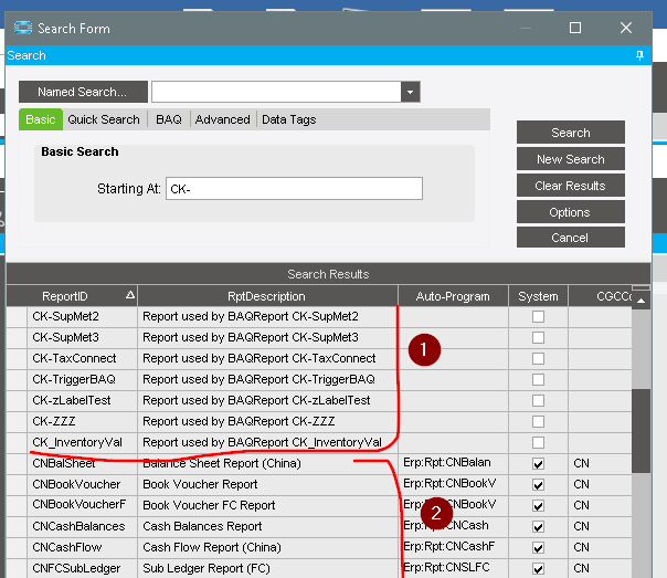

Here’s what I see when searching for a report style. #1 shows BAQ Reports, #2 is some Built-in reports
WHOOPS …

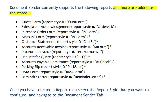

From the Doc Sender guide …
I’m guessing BAQ Reports aren’t
Hmmmmm…I bet there is a way to make it work, but probably needs more investigation.
Question; can I deploy a report style of a BAQ report related to your first question?
Absolutely!
I often make multiple styles of BAQ Reports. Most of the time it’s a basic style for printing, and an “Excel Friendly” style for exporting.
