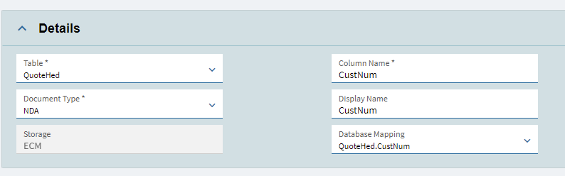

You define the database mapping. So like here NDA on QuoteHed is mapped to QuoteHed.CustNum.
I guess what I am saying is, if you wanted Customer.Name to be included how would you do that there Chadd? Is it possible?
No. The MetaData must come from the same table that’s getting the attachment. I like metadata, I want metadata, but I don’t like the way it works. I’m leaning towards entering the metadata in ECM and then posting it to Kinetic.
You’d have to do it in ECM. There’s not a way to automatically add metadata that’s not available as a field on the table you’re referencing. At least not that I can think of.
Everything said so far seems to be accurate to the best of my knowledge. Document Types will only pull metadata from the table they’re attached to. This is severely limiting in what you can pull from Epicor into ECM in one shot. Also, there are several “calculated” display fields that aren’t available even from that table. Many CustID and CustName fields display based on how Epicor links data tables through the index value, like CustNum.
