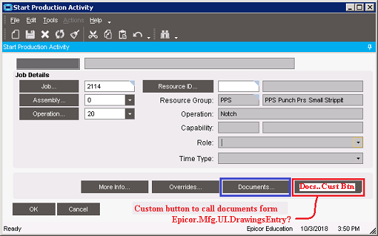

Documents form - LaunchFormOptions?
Wondering if anyone has successfully called the Documents form?
It won’t launch as a standalone form from a menu item
and I’m not having any luck with ProcessCaller.LaunchForm.
Guessing it wants specific LaunchFormOptions ?
Ref. part of a trace from the “Documents” button on the MES Start Activity form…

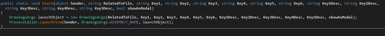

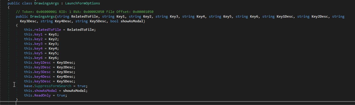

According to my wonderful decompiler, here is how it is called from that form. I note the call you are seeing in the trace. I also see where the RelatedToFile (aka param #2 aka opTable returned from the GetJobDocs table) must be “JobOper”…at least in this case
                string text2 = this.startView.dataView[0]["JobNum"].ToString();
				int ipAssemblySeq = Convert.ToInt32(this.startView.dataView[0]["AssemblySeq"]);
				int ipOprSeq = Convert.ToInt32(this.startView.dataView[0]["OprSeq"]);
				string text3 = "";
				this.drawingsAdapter.GetJobDocsTableName(text2, ipAssemblySeq, ipOprSeq, out text3);
				if (text3 == "JobOper")
					DrawingsArgs.Start(this, text3, text2, ipAssemblySeq.ToString(), ipOprSeq.ToString(), "", "", "", "", "", "", "", "", true);
					return;

Can you please explain the DrawingsArgs.Start Line?
This is literally all I know:
