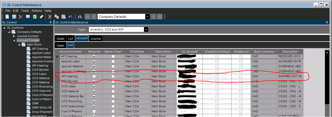

When you do a customer shipment, you should see a DR to your ‘AR Clearing’ account (we call it “Shipped Not Invoiced”) and a CR to your WIP accounts. Then when you invoice you should see a CR to you AR Clearing account, offset by a DR to your COGS accounts, and also a DR to your Account Receivables GL offset by a CR to your Revenue GL account.
For this to work, make sure you have the “Use A/R Clearing Accounting” checkbox on in your company configuration under ‘Modules’ > ‘Finance’ > ‘Accounts Receivable’ > ‘General’ tab. Also make sure you have a GL setup in GL Control Maintenance for the “Inventory, COS and WIP” type for the ‘AR Clearing’ context (see image below).
