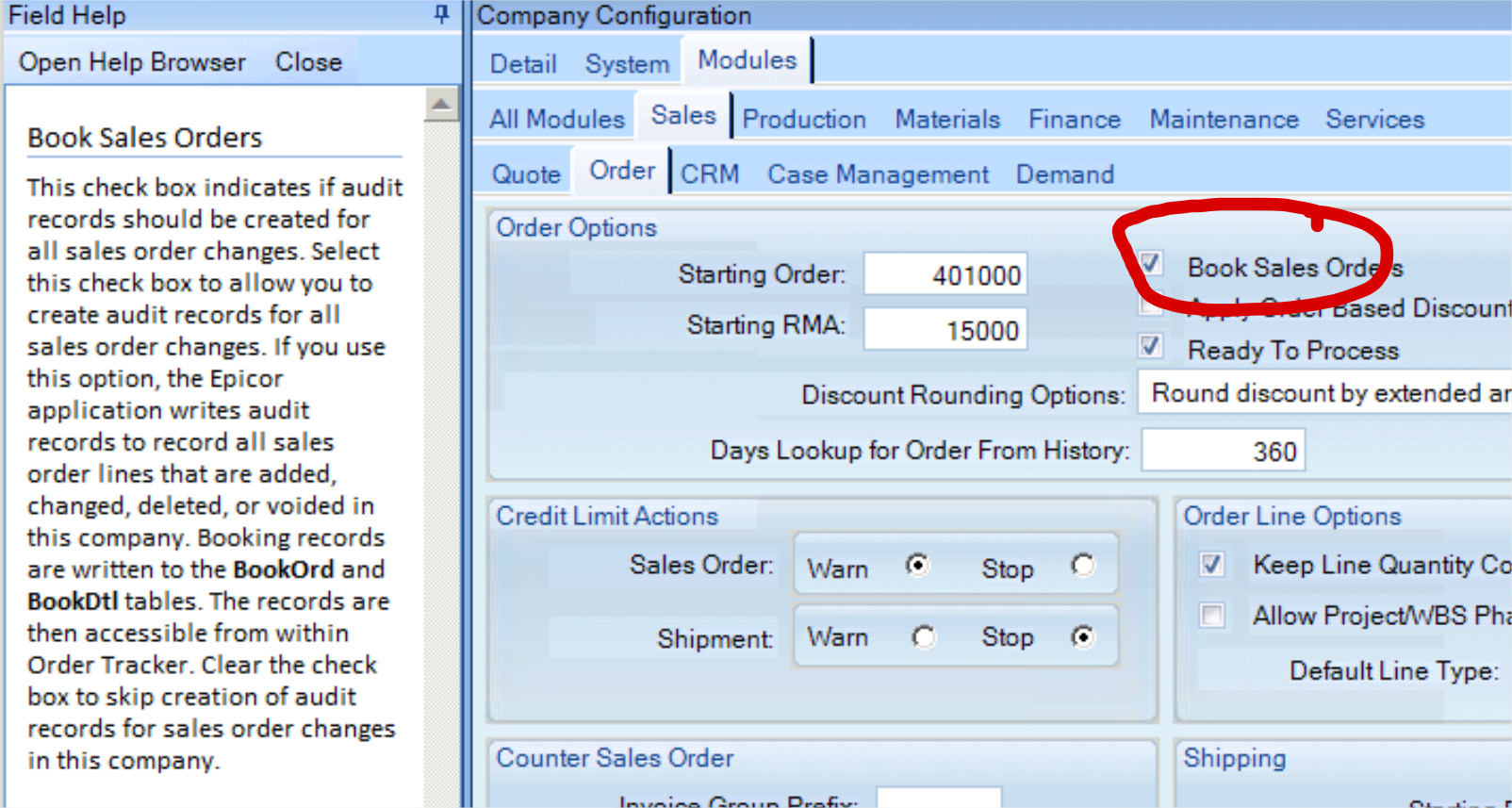

If you enable Book Sales Orders in Company config, âimportantâ changes like Who, when, part, Qty & amount are tracked in the Booking Details tab of each Order Line.
if you need more detail than that, then BAMâs would be your answer, but then you need to decide what all to track and you donât want to track everything.
Actually on the Line/Book Details tab in the Sales order Epicor will
already do this for you. There is also a default checkbox on the company
maintenance form which says âbook sales ordersâ which allows these changes
to be tracked

A word of caution about the Book Details process. It is very sensitive to the âReady To Processâ flag. The records are not written until that flag is checked. The calculation is based on the unshipped quantity on the order. So we found, if a user unchecks the Ready To Process flag (for what reason, I do not know) and then rechecks it, it will reduce the booking total to zero for any line that is already shipped on the sales order. There is no way to change these records (in an Epicor-approved manner) once they are written. Iâm not sure about other versions but it is definitely true for 10.0.700.4.

Thank you for the insight on âBook Sales Ordersâ. From the looks of it, however, this feature ONLY tracks changes to qty and price at the line level of the sales order⌠nothing is tracked at the header level (i.e. who put an order on hold)??
Thanks again.
That is correct. For that you would use your standard BPM Logging, which doesnât give you an easy to track quantity and value change.
