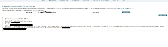

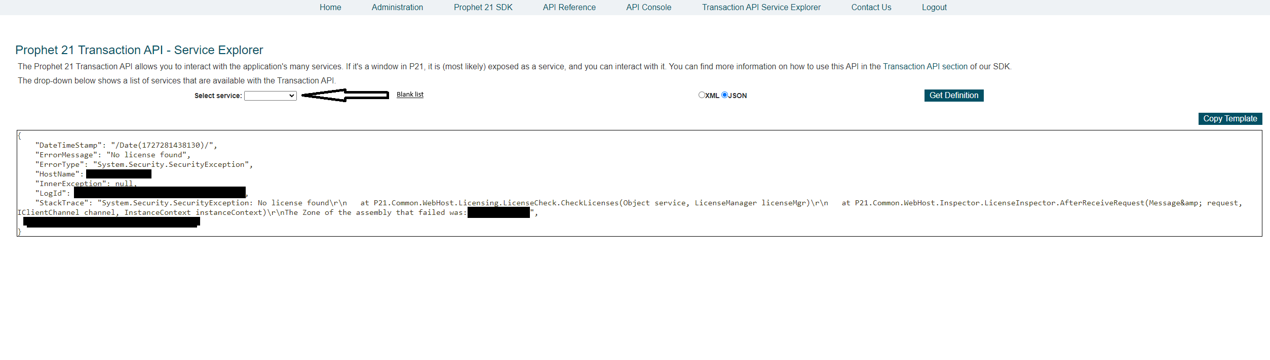

Additionally, when I access the Prophet 21 Transaction API - Service Explorer and attempt to get definitions, all the “select service” options come up blank. When trying to get a definition, I receive the following error:
    "ErrorMessage": "No license found",
    "ErrorType": "System.Security.SecurityException"

Even within the middleware API service explorer when i try to get definitions, i get the same error (Above)
OK, I get a populated pull-down list where you don’t.
