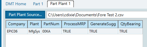

After multiple attempts, I have now gotten both the “Process MRP” and “Generate PO Suggestions” boxes checked on a few different sales kits. But still no unfirmed jobs for the sales kits and no forecast or plan of any kind for the parts in the sales kits. I tried changing the sales kits from non-stock to inventory, but that has made no difference. Any idea what I am missing?

Any chance I could get more guidance on this today? I populated the fields/checkboxes as noted above (Process MRP, Generate Suggestions, Qty Bearing all true), but MRP is still not creating forecasts for the sales kit parts.
