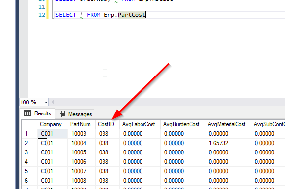

I don’t think so. The CostID for the only PartCost row for my part is “1”. No field of PartCost has a value that looks anything like our site IDs.
Okay, okay, I’ll read it!
Oddly enough, Plant.PlantCostID seems to be uninvolved. The only PartCost for my part has CostID “1”, and all my sites have PlantCostID “1” except MfgSys which is blank.

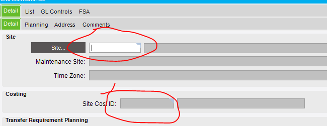

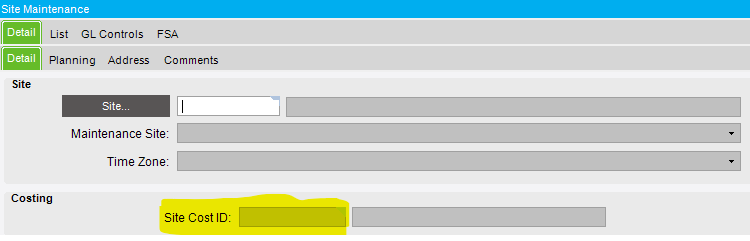

the COSTID for the PLANT/SITE is listed on the plant maintenance.
sometimes - installations use the SAME value for COST ID and PLANT (it’s actually nice)
