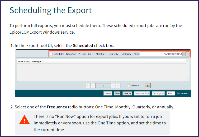

The info. on the tool in the ECM Help menu was quite helpful.
It looks like it would meet my “base case” need for most of my documents.
One item that concerned me: The Export Schedule frequency! One-time, monthly, quarterly – how about every 5 minutes? Or at least hourly?

Note this is for a FULL export and not just single documents. That may not finish in an hour depending on the number of documents you have. It’s worth noting that ECM provides an HTTP link to each document. If you know the link address, then you can use automation (with the correct credentials) to grab a document in PowerAutomate, Logic Apps, or PowerShell and write it wherever you like.
