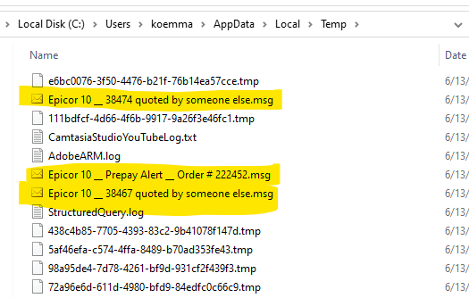

If you are trying to find where the file was moved to, its in your Temp folder.
Open start menu and type %temp% > press [Enter]
The highlighted here are the emails I dropped into Kinetic from Outlook.
