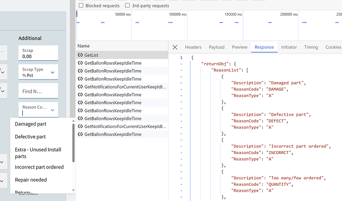

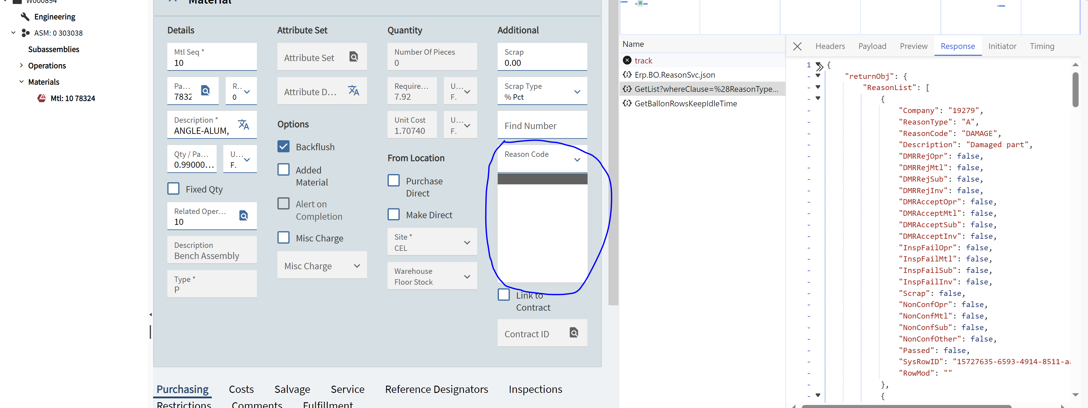

Hi guys, please advise what I am doing wrong?

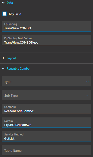

I added a compo box, which is populated from the Erp.BO.ReasonSvc service’s GetList method:

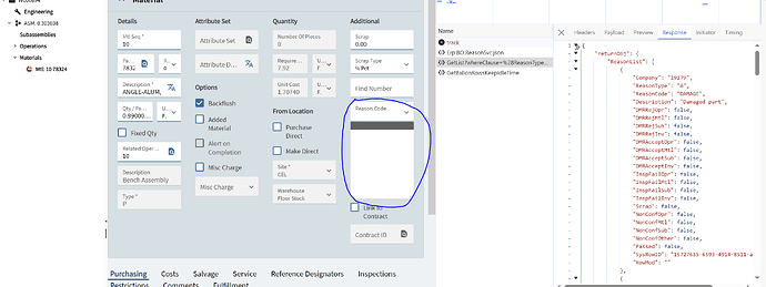

but drop down contains only empty values:

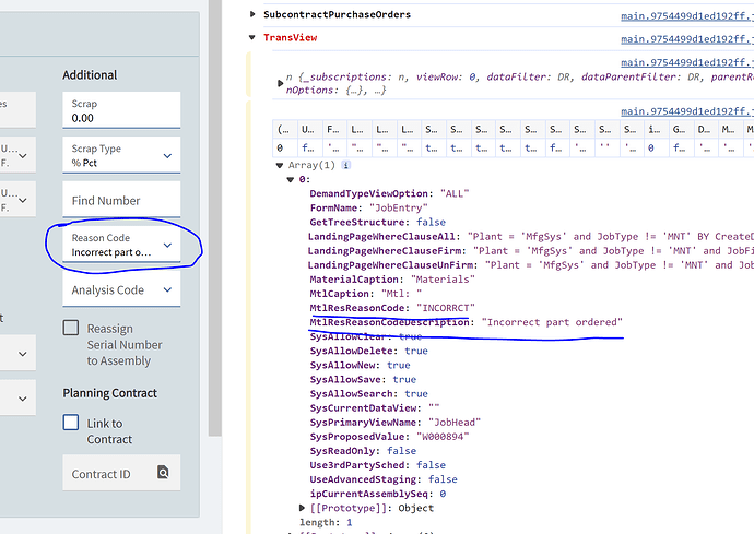

however, when I click on something, I see that value is being picked:

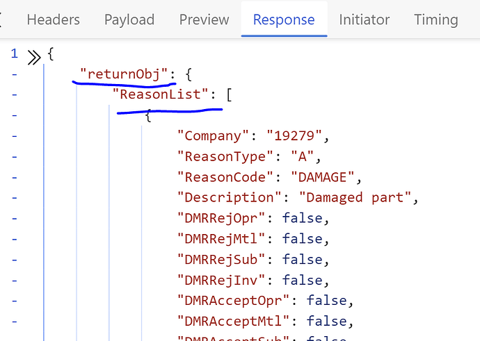

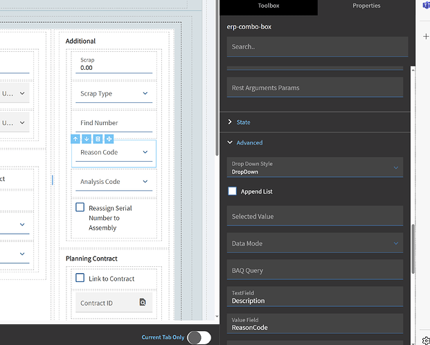

I assume it has something to do with the response model:

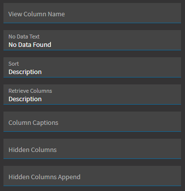

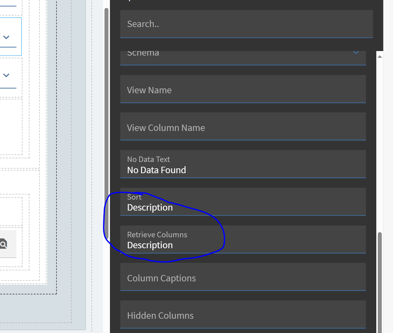

and I tried to use Description as a value for Retrieve columns:

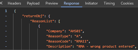

then I tried returnObj.ReasonList as a value for Retrieve columns, but it didn’t help as well
I have a strong suspicion that I can’t use something other than predefined combos/BAQ/UD GetList service here, but I can’t find the reason why, as for me UD service is quite the same, except the response model

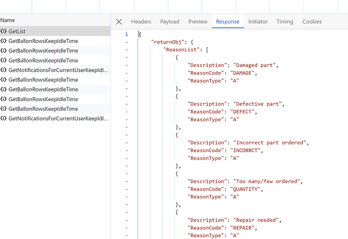

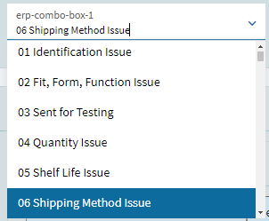

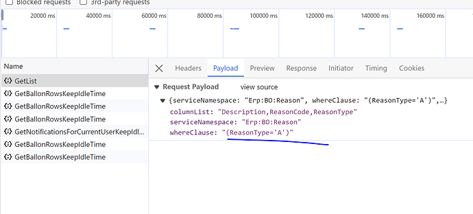

it’s funny, but I did check, and the values it returned, weren’t A type.
However, with the filter it seems it returns needed values:
and drop down seems to be working as well:
so, I have a solution, thank you
but I am curious, what’s missing in my implementation?

I made a UD combo box not two months ago … does it matter what the value of the ComboId field is? I have never put anything there
Could you try it without any value there?

Initially it had been empty, I added value there as an attempt to fix the issue

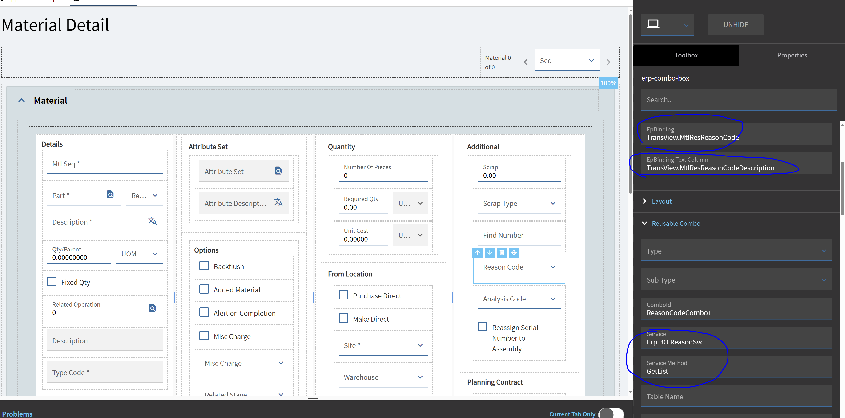

I just threw a combo box with your same configuration on a random screen and it seems to work fine:
With the same response model:
Configuration:
