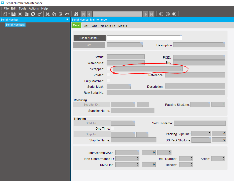

I’m trying to understand why a drop-down selector in the Serial Number Maintenance utility displays 2 options, when the table.column it calls (according to EpiBinding) contains no established values.
Details:
When I click the Scrapped checkbox in Serial Number Maintenance, the drop-down beside it becomes active, and I can choose either “Junk” or “Writeoff Scrapped Inventory.”
(this assumes that I’ve searched and selected a Serial Number value - which, in preparing the screen shot, I did not)

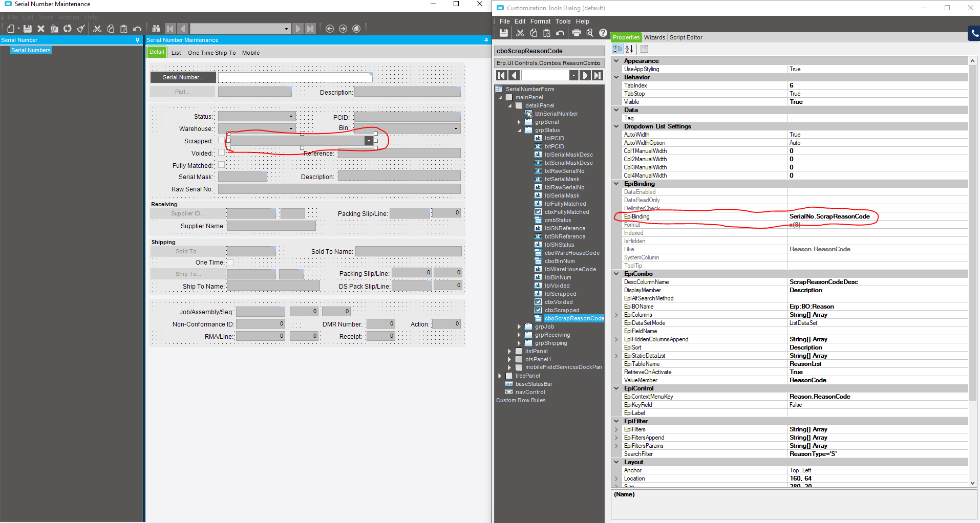

In Developer Mode, I checked the Customization Tools Dialog to see where the selector gets those values.
The EpiBinding value reads SerialNo.ScrapReasonCode.

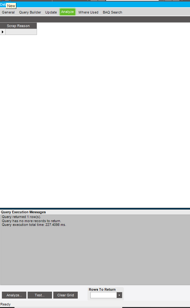

So I made a quick BAQ selecting only Distinct ScrapReasonCode values from table SerialNo.
Only one row is returned, and the value is blank/null.
I have also tried selecting NOT ISNULL values using a BAQ, but I’ve thus far failed to retrieve ScrapReasonCode values that hold any meaning, using a BAQ.

This is just the field binding.
When you select a reason and save it, it will save that reason code to the field binding specified.

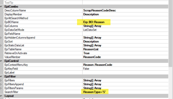

The data is coming from the Erp.Reason table where the ReasonType equals “S” (scrap).

So, SerialNo.ScrapReasonCode is where a reason code is saved after a user selects it.
But it is first made available for selection via the drop-down from Reason.ReasonCode.
Right?
I checked the Reason table. As you predicted, there are 2 codes with Type S.
IVCNT/Junk
SCRAP/Writeoff Scrapped
This addresses my question, and I appreciate your effort.
Exactly.
The combo box is displaying the data from the Reason table. When a user selects one and hits save, it gets committed to SerialNo.ScrapReasonCode.
