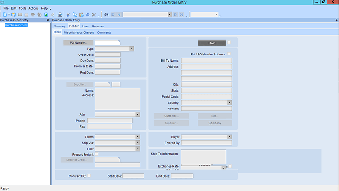

Did you manually change the address on the PO Header to the drop ship
address (or use one of the buttons to search for a customer/supplier
address) and click the checkbox that says “Print PO Header Address”?
E9. Okay I went in and I see the Header. It is populated with the default company address. Do I need to uncheck the Print PO address and manually enter the Drop Ship address?
Yes check the box. You can then manually enter an address or, select from
one of the buttons to execute a search for the address you want and then
approve the PO and that address will print
