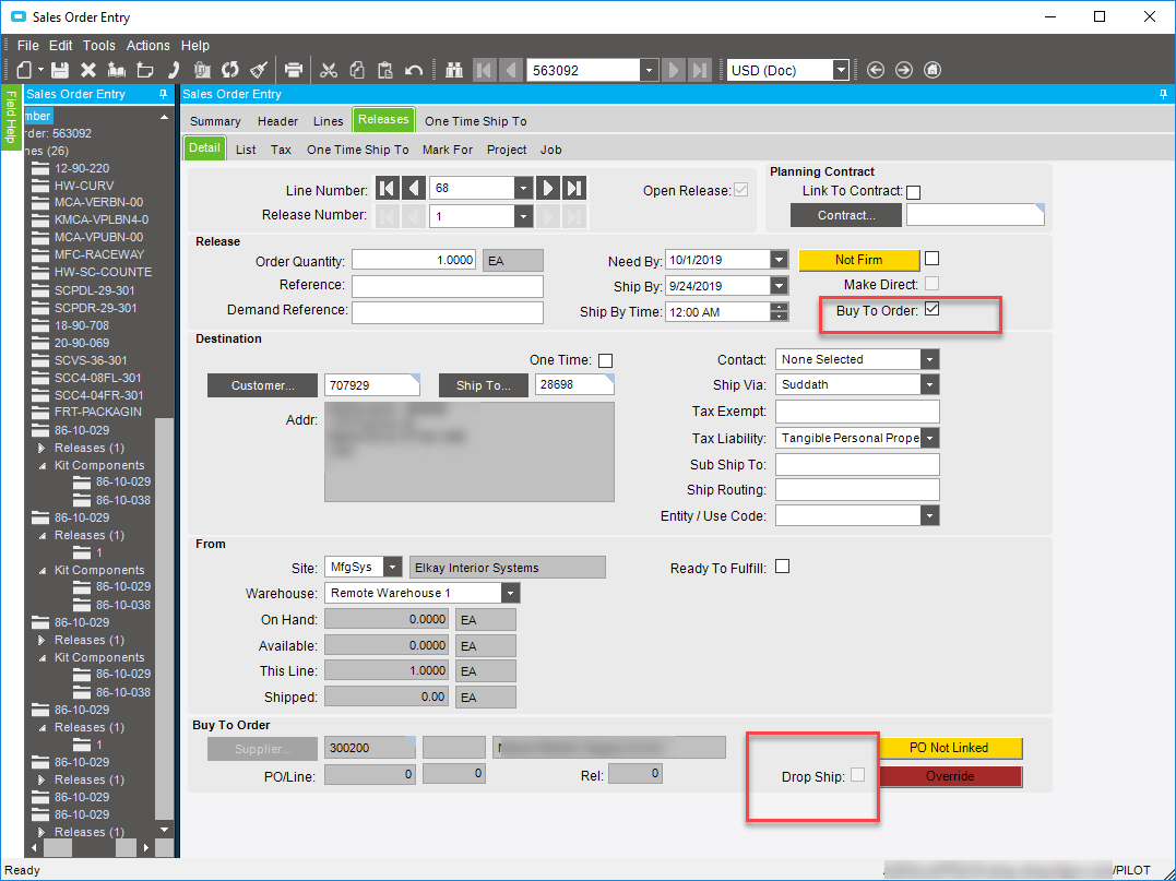

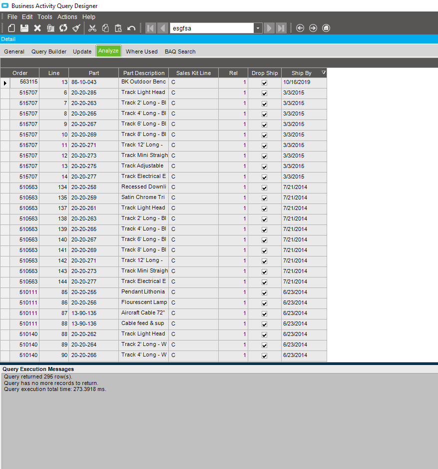

Supposedly, our pm team used to be able to mark a kit component as drop ship and I have a BAQ that proves that fact. Nobody seems to know what changed, if anything, but now the drop ship box is grayed out. Any idea why I can no longer select it for the kit components?

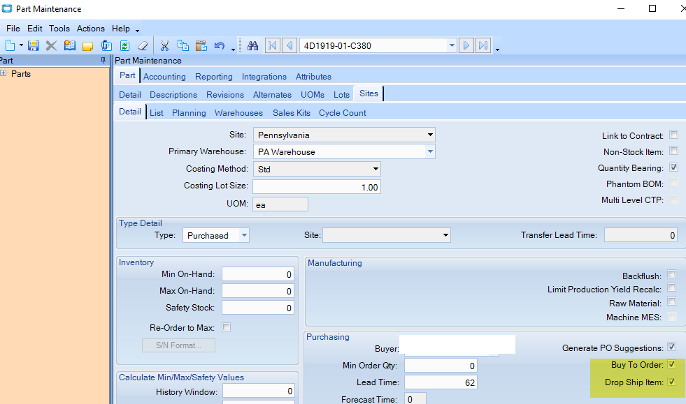

Are you sure you used to be able to do this? We do use kits and we do some BTO and drop shipments, but have never done so for the kits. When I go to part maintenance and try to change to Buy to Order on a part setup as Kit, I get error that BTO cannot be turned on if one of the Part sites is kit per below. I checked my method directives and it is not due to any of them, it appears std processing in system.
We are on 10.1.600.20. The part you screenshot above is not a KIT that has BTO and DS checked. It’s a purchased part, so not surprising you may check these on it.
I see you are on 10.2.xxx. So how long ago do these folks recall this functionality? I don’t see it in 10.1.600.
Nancy
Yes, I’m sure at one point it was possible. We have close to 300 order releases that were marked this way. However, most are <= 2015 and we upgraded to 10.2 in 2018. There’s only one in 2019, but that would mean it’s still possible.

I have run a test with a P component part setup as BTO and DS as part of a kit. I get a BTO PO suggestion, but no DS on it. When I create the PO, same thing. So… no go in 10.1.600.20.
We have just encountered this same scenario. Were you ever able to find a solution for drop shipping sales kit components? We can get the PO to recognize the demand for the sales kit components from the sales order, but the PO doesn’t mark the PO lines as drop ship.
