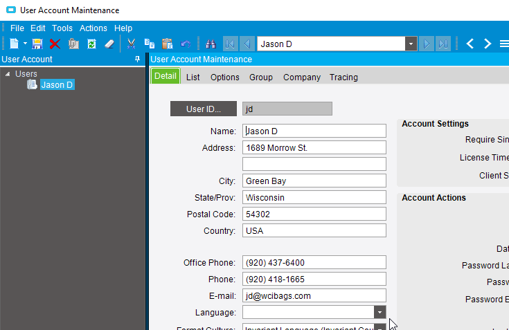

Duplicate a user
Would be nice.
@jgiese.wci show him :slight_smile:

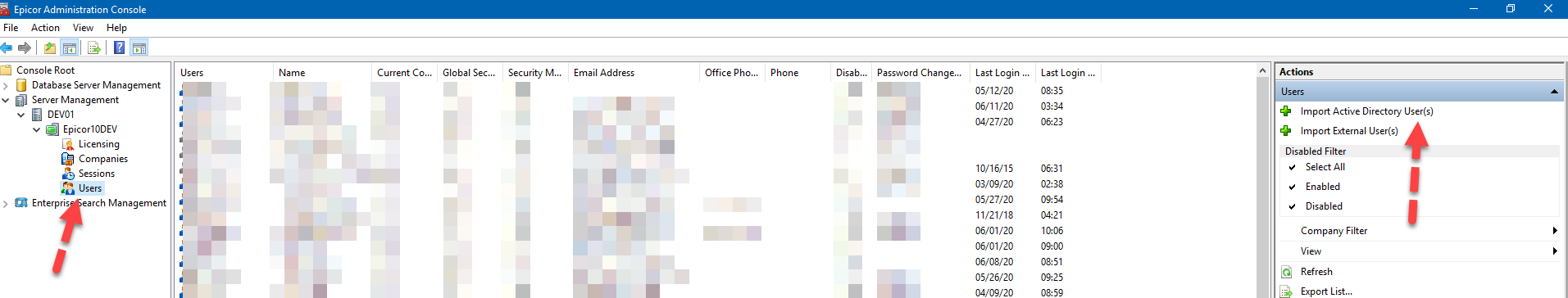

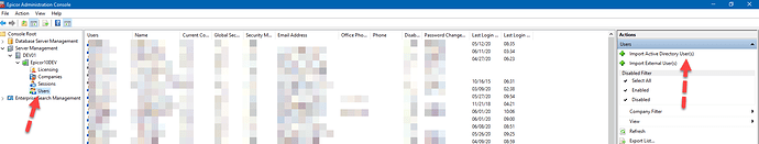

You can create a new user with an existing user as the template to copy over all of the actual user account configurations via the Epicor Admin Console. It doesn’t create all of the other stuff though (workforce, employee, etc.)

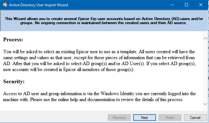

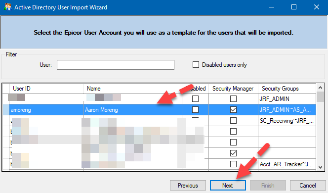

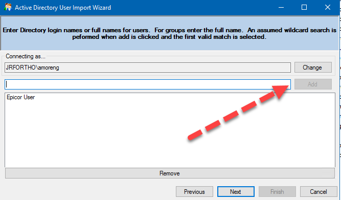

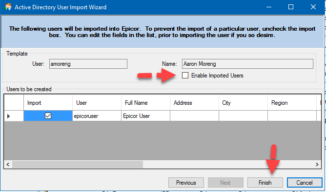

Yes I believe it carries over everything from the user account (security groups, config, company, plant). To duplicate a user use the Active Directory Import process ( don’t know what the External users process is)
But basically you’ll pick a “template” user, select your to-be-imported AD user by entering the AD name and click Add, and click finish.
You’ll want to make sure to either enable the user direct from here with the enable option or do it in user account security

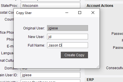

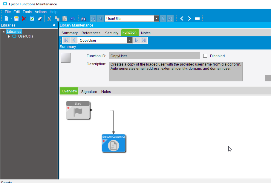

10.2.600+ with REST enabled on the client side plus Efx = awesome

@Aaron_Moreng Just tried the AD route and that works really well.
@jgiese.wci You all and your Epicor functions. Very nice.
But, we are SSO and I did the AD copy and it did the math on the OSUserID just fine, so I don’t understand your issue (or they fixed it?).
To wit,
  1. AD import wizard in EAC
  2. Template user was Jimmy James (not really; just go with it)
  3. New user is Marky Mark
  4. Jimmy’s OSUserID was JJames
  5. Marky is MMark in AD. Epicor user MMark was created with OSUserID of MMark (but all the same other settings as JJames. (i.e. exactly what I wanted)
