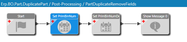

I’m attempting to create a BPM that removes the primary bin from a specific warehouse when duplicating a part, but it’s not actually wiping the field. Did a trace, saw that the Part.DuplicatePart BO is firing, so I created a Post BPM with two ‘set field’ widgets and a message box (for PrimBinNum and PrimBinNumDescription). Message box shows up.
We’ve got two warehouses (INSP and IOWA), and the trace shows both sequentially in the data set. The BO is only triggered once. RowMod is blank.
I tried changing the SetField from a “” expression to a different BinNum, but the original still appears.

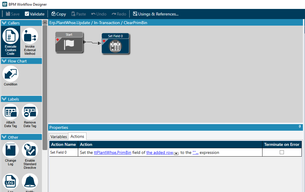

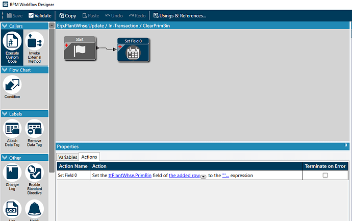

I set the PrimBin in a data directive on PlantWhse for our finished goods warehouse. I made a quick change in test and I can wipe the PrimBin on a duplicated part.

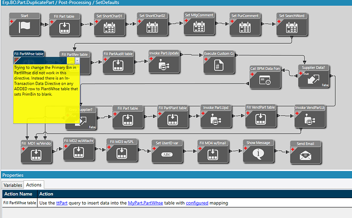

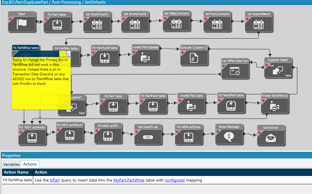

Here’s a screenshot of my current Duplicate Part method BPM, with a relevant comment:
And here’s the Data Directive that is currently in place and working:
Note that the data directive is on PlantWhse, not PartWhse. Maybe that is a clue as to why the method directive doesn’t work the way we initially expect? I don’t recall the details.

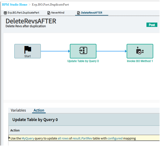

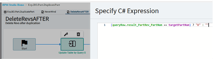

2 widgets:

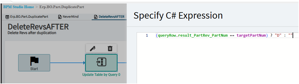

First one: Bind automatically everything except RowMod…
…which I did like so.
Honestly I didn’t even check (in the trace) to see if both parts (new and old) are in the final dataset. The point here is that IF they are both there, it only deletes the revs of the new part. (Perhaps it is only the new part, and all that’s needed is just to set all to “D.” :man_shrugging:)
Second widget is just the update.

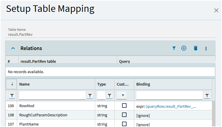

The “Bind automatically” thing [IS FINE.] seemed to only do the first 80 rows. Feels like a glitch.
Here it was irrelevant, since I was concerned with doing two things: nothing, or delete. Either way, I don’t give a hoot if the temp dataset is accurate except for primary keys.
But if I was doing something permanent, this might be a problem.
[EDIT: see my comment 2 posts later. Binding automatically is fine. The BPM query seems to have grabbed only the first 80 fields when I checked “all” using the checkbox in the header and I had failed to verify that they all moved to the display side.]

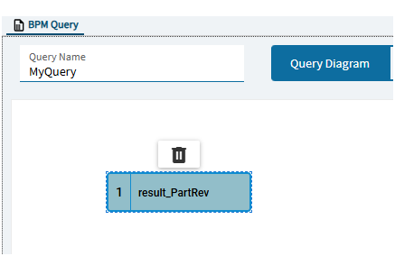

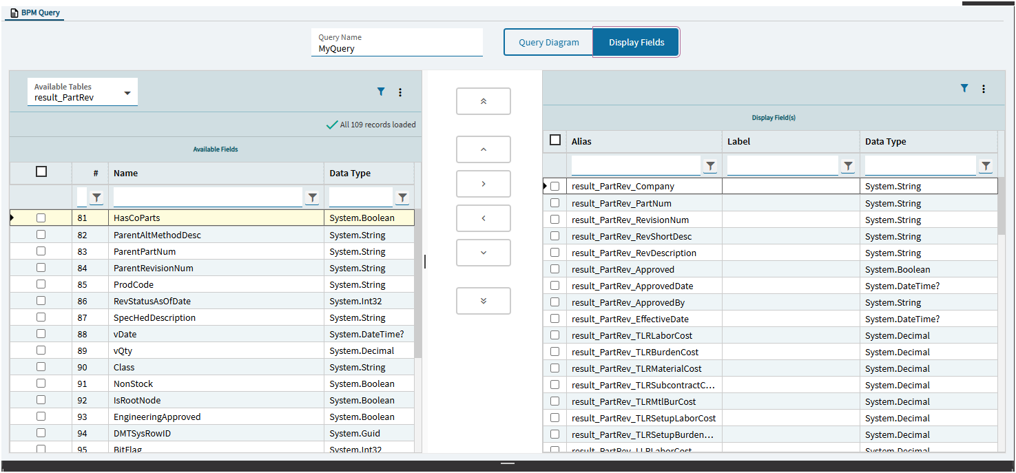

That looks very promising, and I was trying that, but could not get it working when I tried it. Could you provide details on how your MyQuery is set up? I think everything else makes sense.
Oh it’s just a dump of all PartRev fields.
Aha! That’s why it only grabbed 80 rows! Not the mapping’s fault; it’s the query.
So here is what I did, but you’d really want ALL 109 rows.
