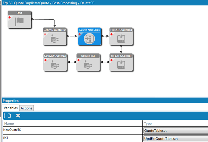

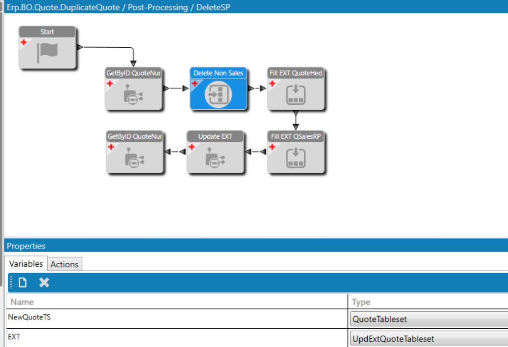

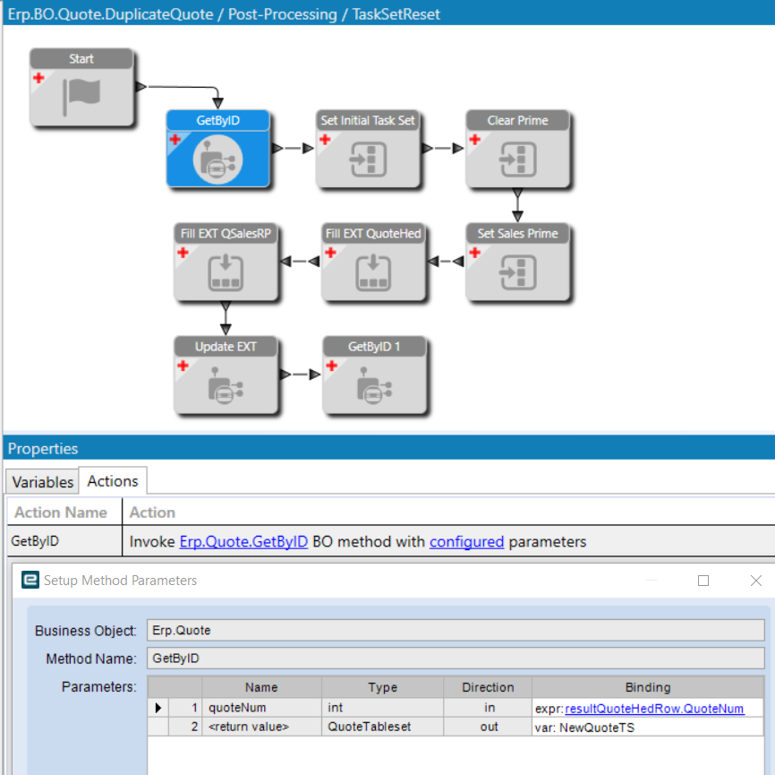

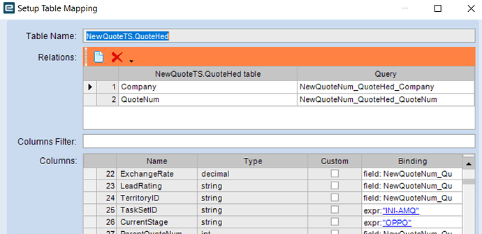

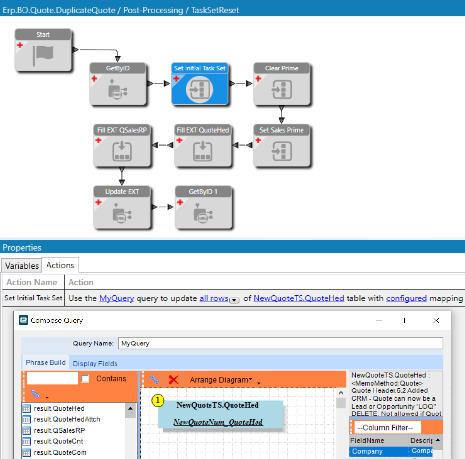

So with a bunch of guidance from @utaylor (Utah also gave credit to @hkeric.wci) we used 2 Post Processing method directives on the Business Object DuplicateQuote. The first method directive resets the task list and changes the Primary Salesperson to the default record.

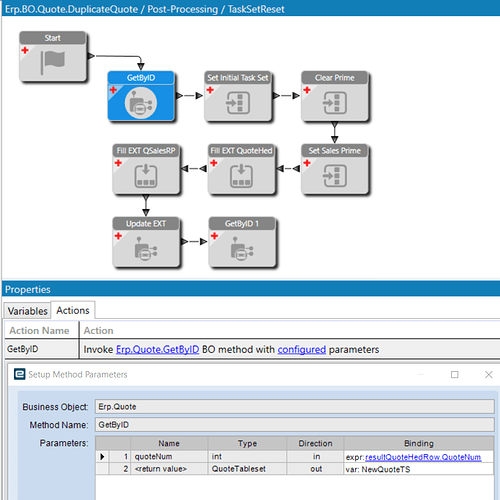

Haso said to always start directives with GetByID and also end with GetByID. This (I think) refreshes all of the fields properly so that the User Interface shows all the selections properly.

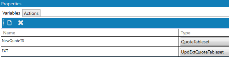

The Variables we used were:

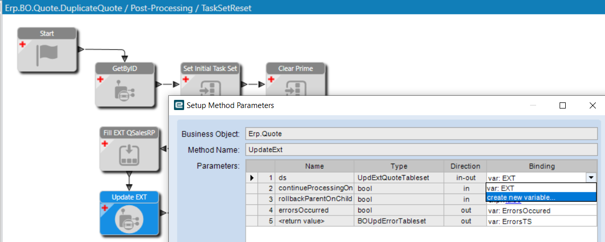

We created the EXT variable like this (the error messages help us diagnose but are not necessary to run this properly):

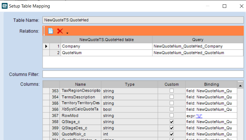

For the Update table by Query, we pulled the data from the TableSet.

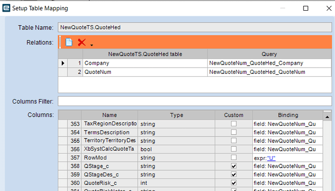

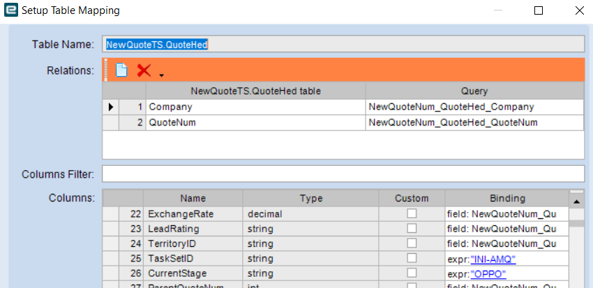

When we configured the mapping, we did the following: Bind automatically, but changing these:
We also forced the RowMod to Update:

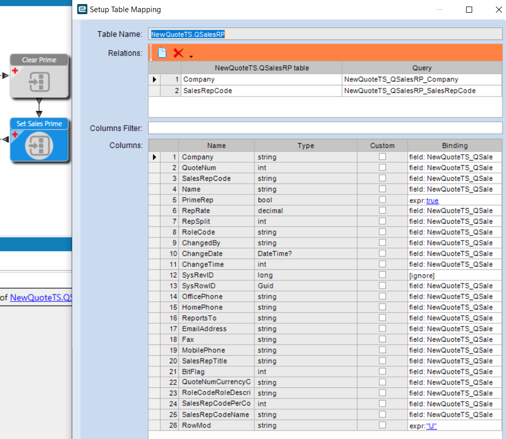

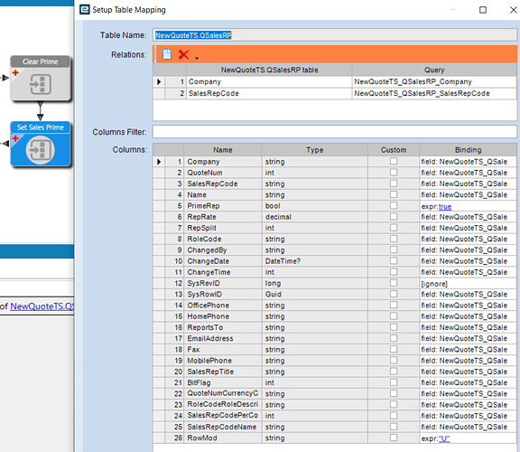

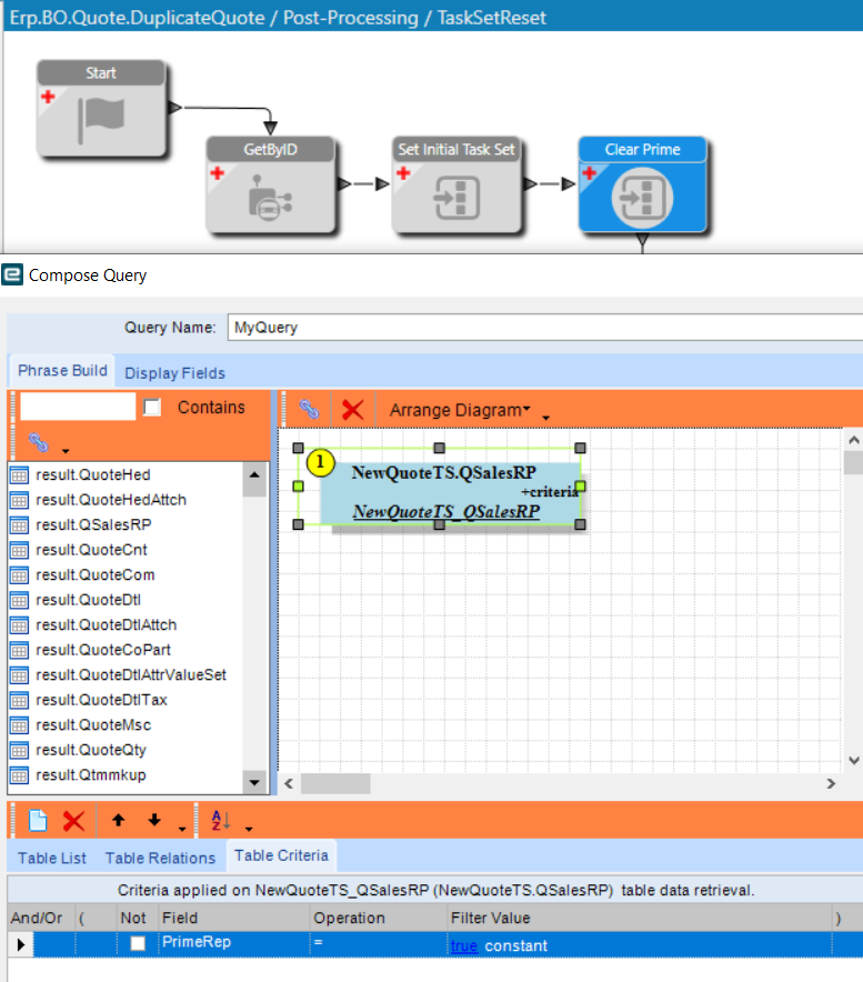

To clear the Primary Sales Rep we used another Update table by query widget using a Table Criteria of Prime Rep = true:
Then we Changed the primary sales rep to the default (so we could eventually delete all others; because you cannot delete a primary sales rep)
Then we used two fill table by query widgets. One for QuoteHed and one for QSalesRP, binding everything automatically, except for RowMod forcing a “U” update on the QuoteHed (letting binding everything automatically on QSalesRP).
Then we added the Invoke BO ERP.Quote.UpdateExt and created the Variable EXT.
Then we copied the GetByID (to refresh the User Interface, I think).
Then on the second Method Directive (a second directive was needed because each directive can write to the database only once; before we did this we would get an error saying delete of the Primary salesperson is not allowed).
We deleted all of the sales reps that were not the default (that we previously made the new Primary). And per @hkeric.wci, we have used GetByID at the start and end of this directive also.

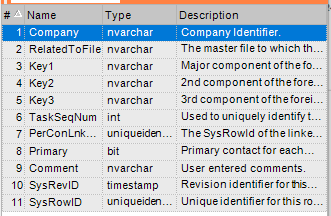

I think my issue lies in my Update table by Query because when I create a message showing my UpdExtTaskTableset, I see all the column headers, but I do not see any data.
What is the TaskCnt table used for?
There are only 11 columns of data:
I noticed that the PerConLnkRowID is unique, but the BPM won’t let me set the variable of “System.Guid” type.
This table does shows up twice (in the parameters of the Update Method of BO.TaskImpl in TaskDataSet) on a trace if I show Full Dataset (but not for show changes only). The first time it shows the “old” SalesRep and the second time it shows the “new” (intended) sales rep, but the duplicated quote still shows the “old” SalesRep.

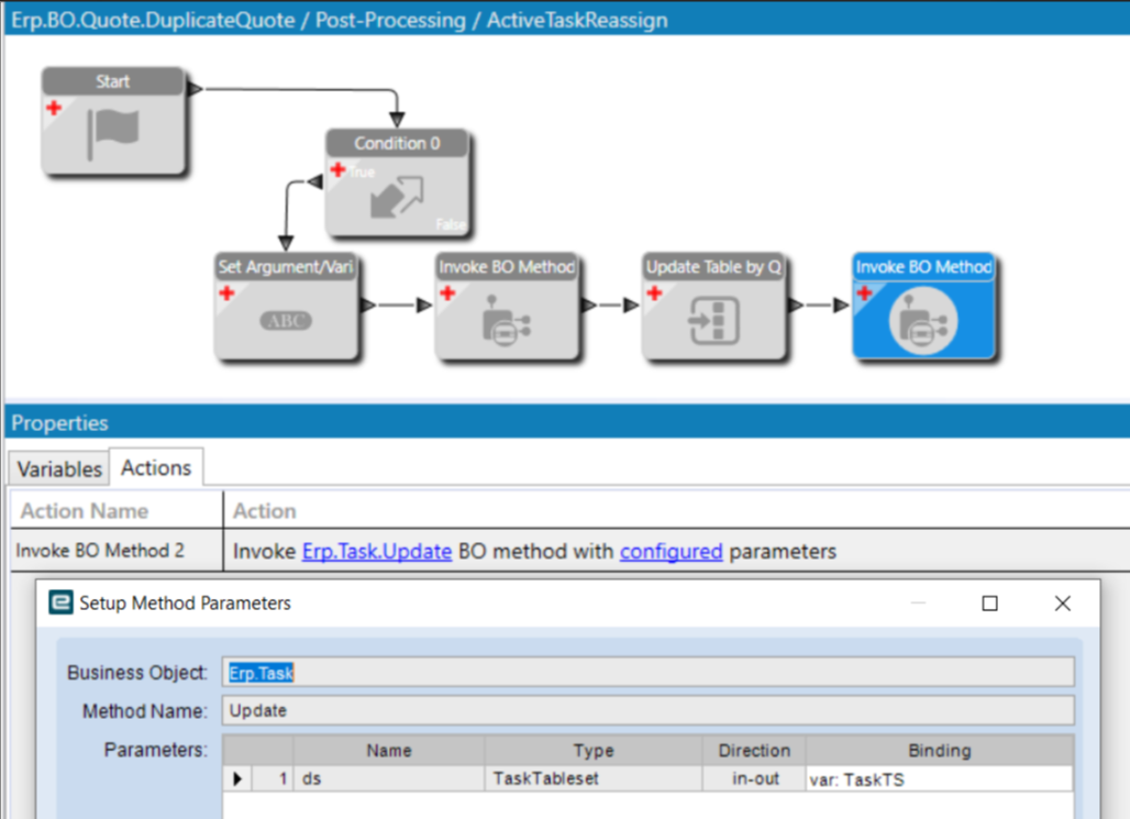

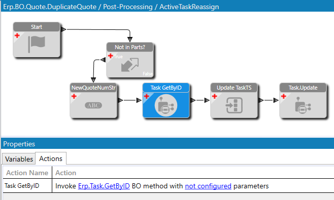

So now I have added a 3rd Post-Processing Method Directive on Erp.BO.Quote.DuplicateQuote.
The 3rd directive reassigns my active task (I am not sure why it did not work when I tried to make this occur in the existing directives).
It is a pretty straightforward directive:

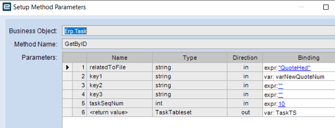

The condition just ensures that the user is not in our parts group. The Set Variable gets the new quote number in string format. The Task GetByID fills in the TaskTS tableset:

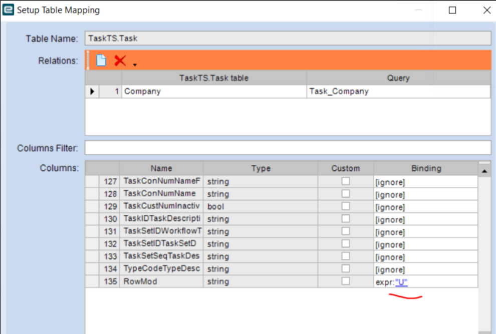

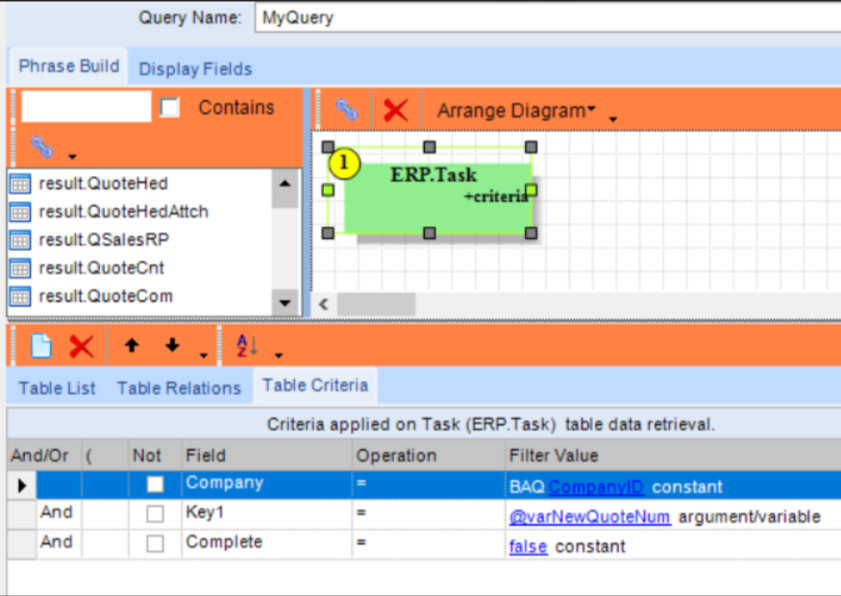

The Update table by Query uses the ERP.Task table with 3 criteria:

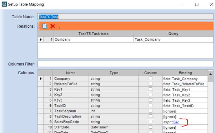

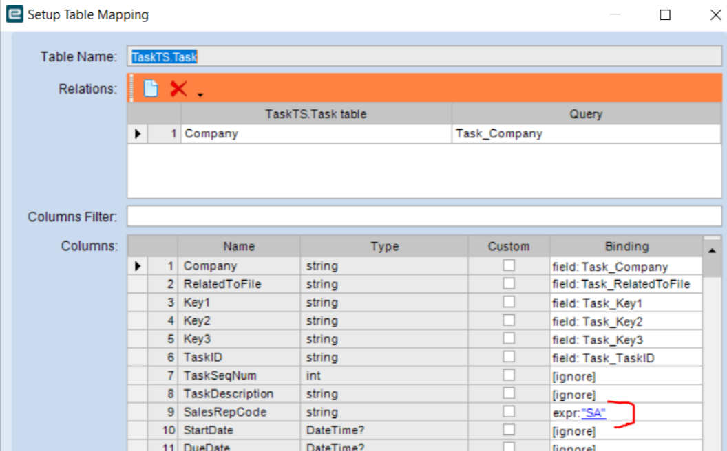

The mapping configuration looks like this:
And don’t forget to set the RowMod to “U”
The the configured parameters in the Task.Update method look like this:
I think the issue I was having was I was trying to use the Task.UpdateExt and it was not executing the change to the Assigned To of the Task. When I switched to Task.Update it worked for me.
