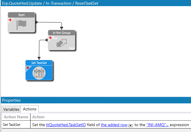

I could not make anything work with the method directive of Duplicate Quote. So I used a data directive on QuoteHed.Update, with a condition on the group the user who called the method belongs to. Then I set the TaskSetID field of the added row to the initial stage I wanted.
That piece seems to work in testing.

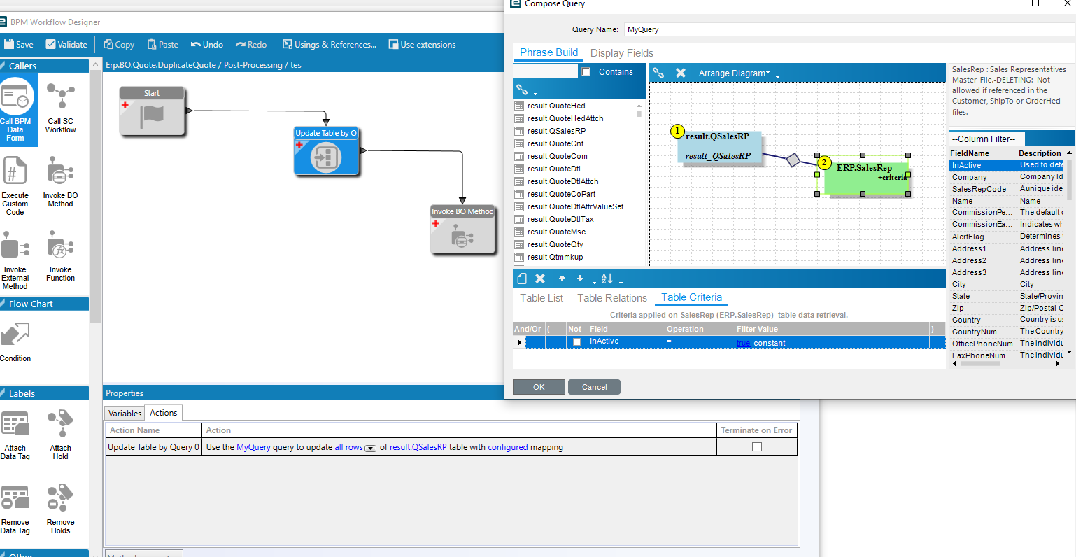

@BKen I was playing around with it and you could probably use a post processing BPM on the QuoteImpl.DuplicateQuote method.
You can loop through the result set from the QuoteImpl.DuplicateQuote method to find the QSalesRep Table and then from there you can update RowMod = D for each sales rep that you would like to delete from the dataset. Then send that dataset to a QuoteImpl.Update method and those people will be deleted from the quote.
@BKen if you want to work on this after 5PM EST tonight let me know.
Thinking you can do something like this with widgets if you want. You design a query off your QSalesRep Table and then you join the actual sales rep table to that where salesrep.inactive = true.

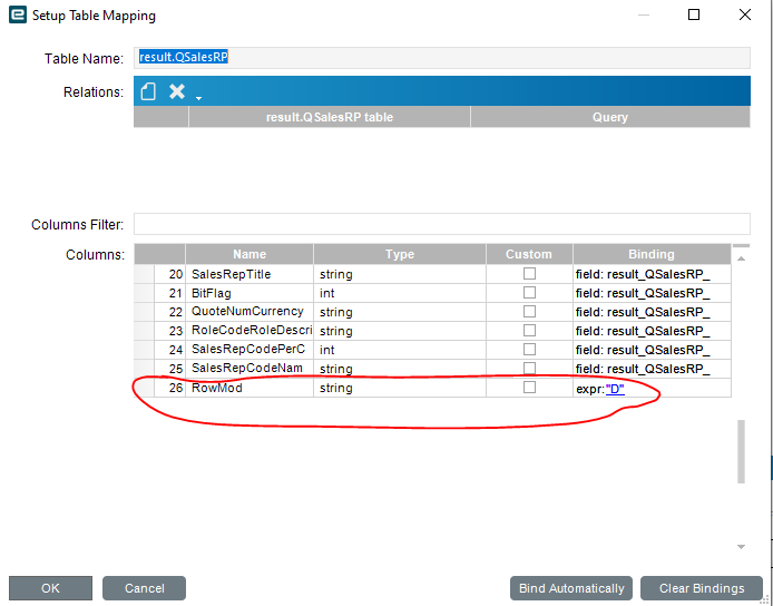

Then you’ll have all the rows that you want to delete so you set the rowmod = “D” in the configured mappings portion (second photo).
I don’t know what you mean by “Not one of the 4 defaults,” in your post above, but there’s a few different ways we could get those defaults and then make a condition to set the rowmod = “D” for those that don’t match.
Ultimately you send this whole result set back to the Quote.Update method to delete the rows you marked to delete.
