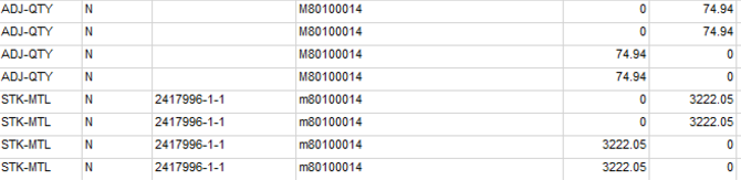

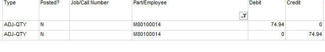

I saw Hannah had a similar question a while back but no replies. Here In my case I added the PartPlant table to the Inventory WIP RDD as relationship type Output and linked on fields Company = Company and TmpPartNum = PartNum. Bringing in the person ID and cost method. This works fine for all but one part number. This particular part causes duplicate rows on the report if run with no filter. If I filter for a Tran-Type or Job it does not duplicate. I’ve queried the PartPlant table and there is only one record.

Looks like it is a case issue. What is the part number in the part table, m or M? Whichever one is wrong, I would try and find out where it is entered and see if you can fix it.
The job material has the lower case but the dupes don’t seem to care as the are duplicating on either. They are also stored in the part tran and not updatable.

My next step was to dump everything and see what shakes out. Something is hiding under the covers. The odd part is filtering seems to fix the issue. ADJ-QTY in this case.
